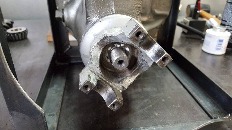

As I noted in another post my 1968 vintage SG 741 is leaking around the pinion bearing. I went ahead and pulled the nut and flange. The flange surface has a mark from the seal but no groove or wear pattern. My mistake was I didn't look at the tech help before I removed the nut/flange so don't know where the original position or turns of the nut. What is my procedure now when I go to put it back together? Is there a preferred seal for this?

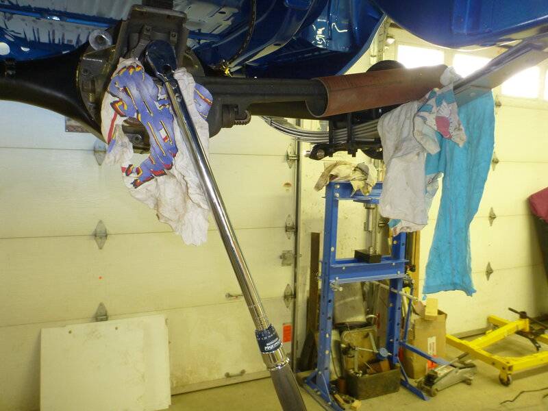

Looking through my notes I might have torqued my pinion nut to 150 ft lbs. I did the 240 ft lbs once and broke my torque wrench!

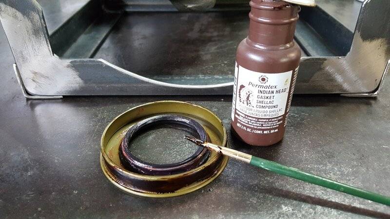

It's an option but I use a little smear of Indian Head where the seal seats. Not on the rubber but on the outside. This seal is showing grease on the rubber.
