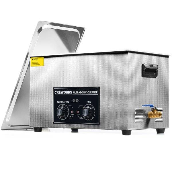

I bought the largest one, 30L 7.9 gal.
Reading the reviews and talking to my friends, I got one with as little digital as possible.
I got it to clean carbs, and it works.
You have to be carefull as to what cleaning solutions you use.
Cleaning junk steel is easy with super clean. Or derust with vinegar.
I have mine set up next to a sink, so I can drain directly. You will be changing the water ALOT.
I wish I could have a bigger one, but the price point jumps to the thousands.

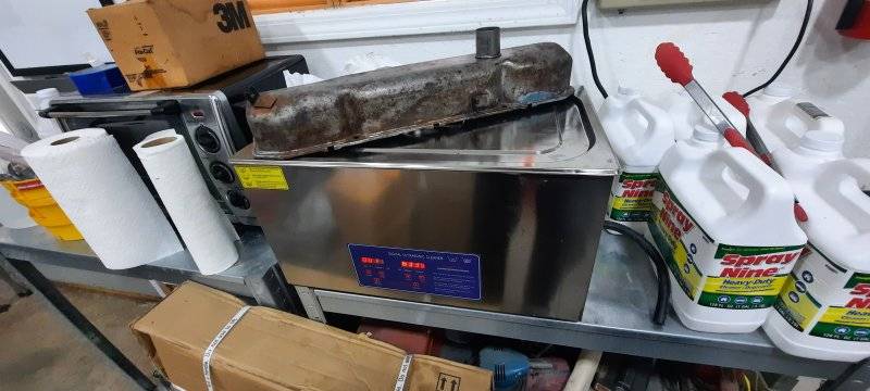

Vevor 30L unit here. Have used on a number of parts. I've had success with Spray Nine cleaner for steel items. Pine Sol with hot water for aluminum items.
Example shown: Valve covers that had two coats of paint and rust. Once the ultrasonic Spray Nine fluid was very hot, the valve covers were soaked multiple time cycles (shown mid-way through the process). Paint and oil removed. No harm to rubber.
Valve covers were then treated to Evapo-Rust soaks, sanded, primed and painted.
Note: Valve covers were too large for unit and had to be done half-at-a-time.
