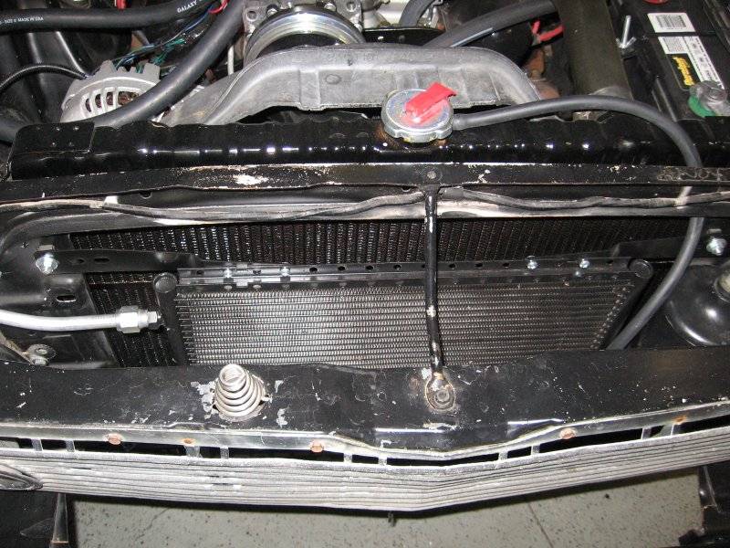

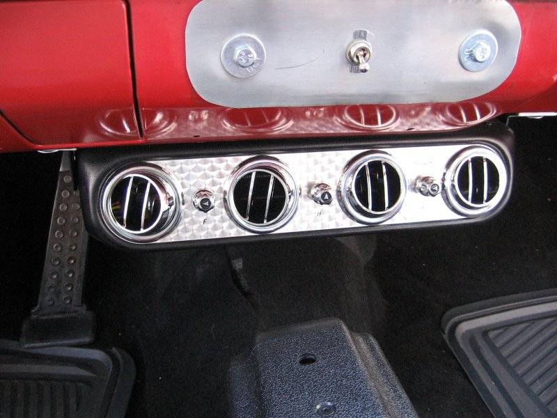

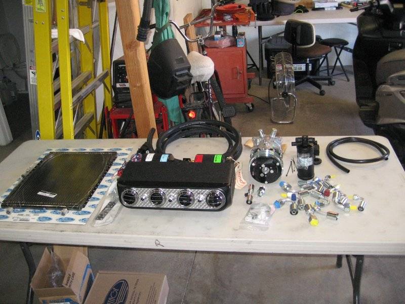

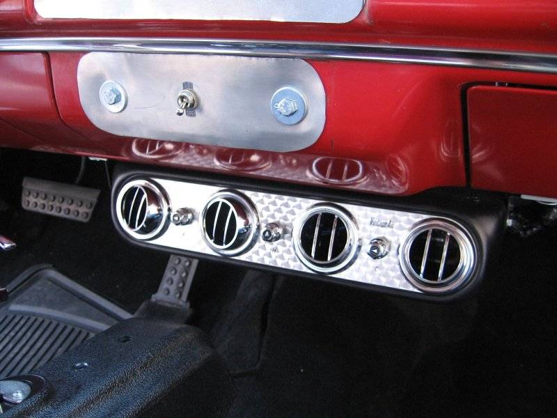

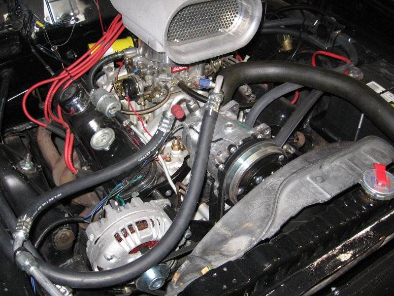

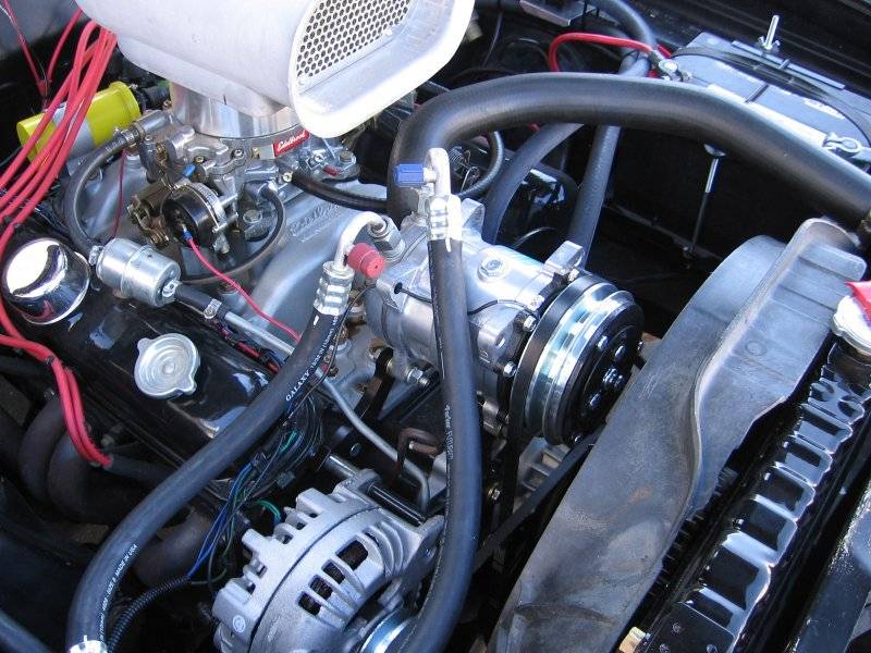

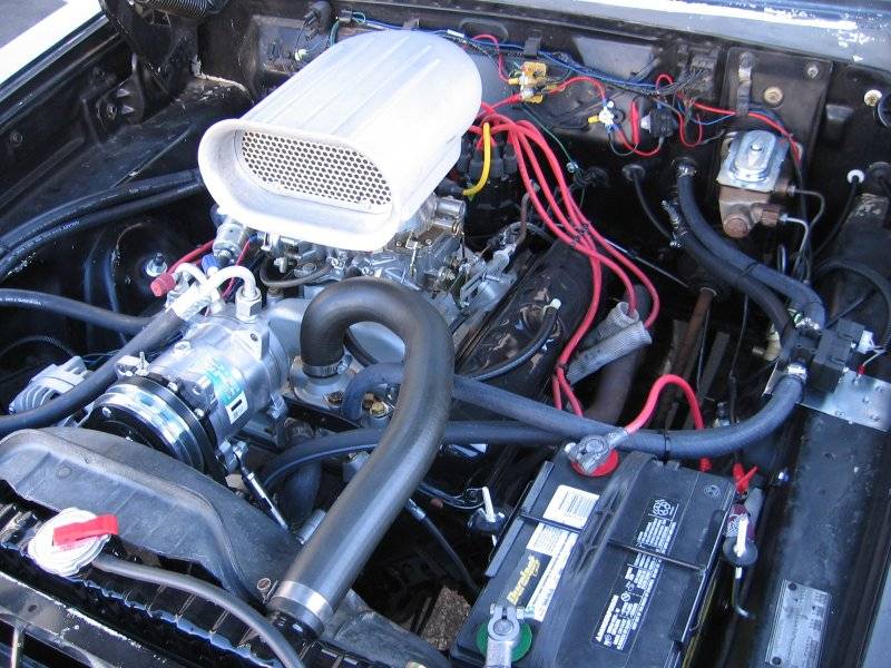

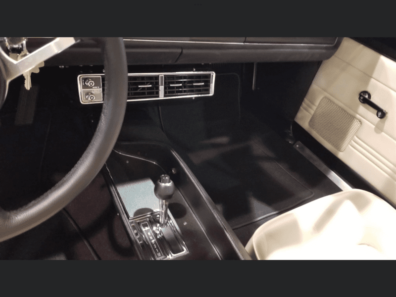

Do you have any pictures from engine bay and interior after the install?
808 Sport Fury, This is Vintage Air photos you asked for.Not the best with a camera.
A few more. Sorry for the thread hijack 417guy.
Nothing pretty as this is a left over parts car that had a good title.
Figured what the heck build it with my stash of parts.
I like the way it looks ! The under dash unit is from Vintage ? All the a/c parts from Vintage ??

Your under dash unit has heat, too ? Does it have any defrost outlets ? I like the idea of yours, but humidity here in the spring and fall need a defrost occasionally. Nice car and nice work, too !
Sorry to say no defrost vents. Vintage Air may have a unit that does.
I almost didn't even get the A/C Heat one it was a last minute thing.
Not much humidity round here.
