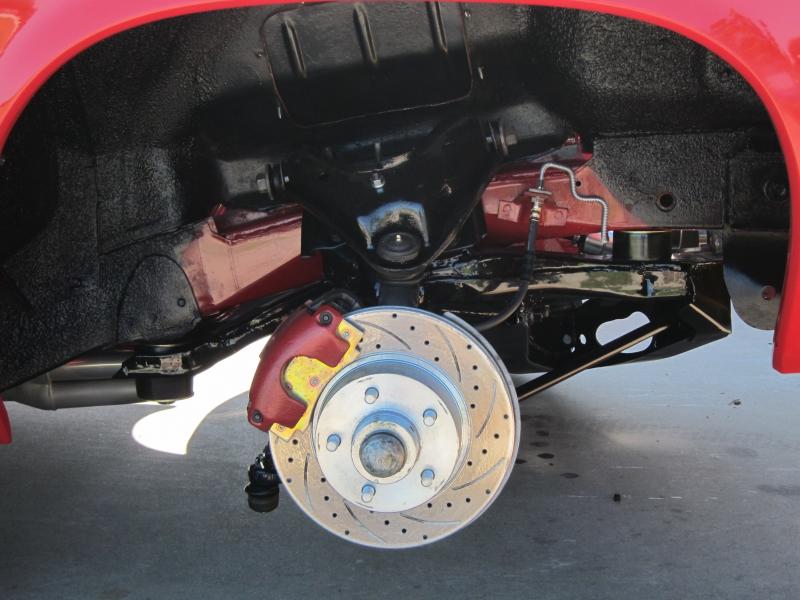

I did the wheel wells on my 73 RR with bedliner and i think it looks great. You are always trying to get at something underneath if you drive it much so the undercoating would only make it more challenging to work on. The Bedliner is expensive but well worth it.

Undercoating the wheel wells would be the easiest way to go,, plus a more realistic appearance to what the car would have looked like back then,,,,but the bedliner is the best for durability,,,just more work, time and expense involved,,,
