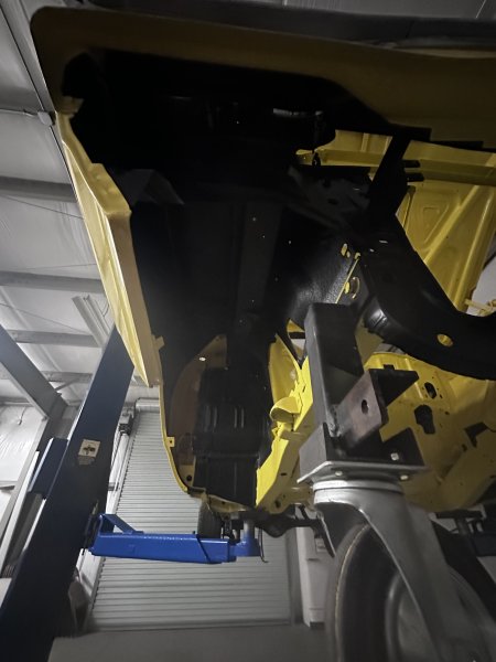

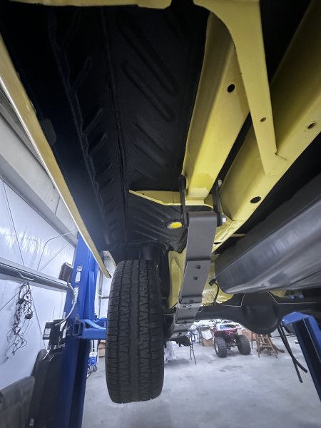

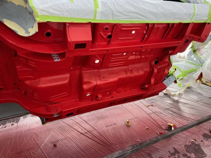

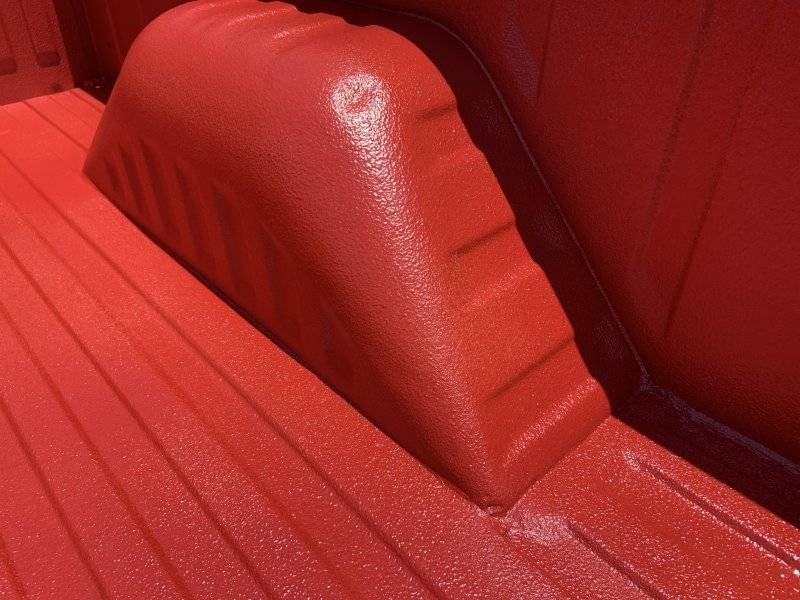

I used the tintable Raptor liner inside the wheel wells on my 71 Runner.
I did not use a gun, I used a small 3" foam roller as the shuts gun does not spray upside down very well.
It's hard to see the finish in these pics as its all white.
