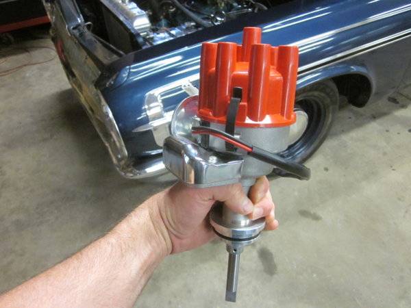

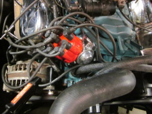

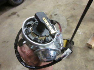

Threw it back in and started fine. The timing light works better now.

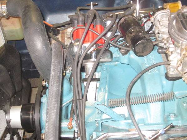

For fun, I decided to try the chinesium dist I had. Basically, it connects directly to the coil with the BR bypassed and the ECU disconnected. Started up easily and ran well, setting the timing at different spots between 12-18*. Seemed to like it around 15*, but still stumbles once it is warmed up. Needs a better coil I think. Going to pick up one next week, open the gap a bit and try it.
