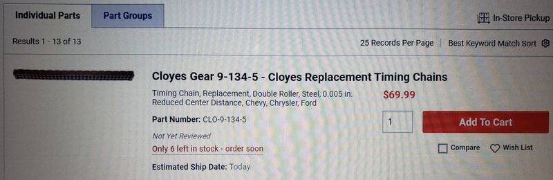

Maybe another option is a Cloyes undersize chain only and using the sprockets you have. Just a thought.
I would try that idea if I could find one. The tech guy at Cloyes didn't think that would work but I'm
up for trying anything. I'm going to get a three bolt sprocket and see what the difference is. If I have
to machine something, I can do that. Tomorrow is another day!
There is no such thing as an "undersize chain". Give a chain an hour of runtime and it'll be a half inch longer! It's the sprocket that is a fraction larger in diameter. That way you can swap chains whenever the need arises.
I just bought two so I will have one for next time!
