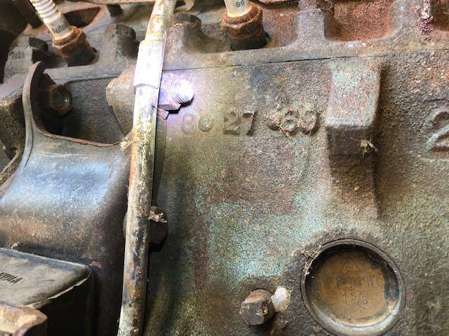

I have a 383 that I just tore down and will be taking it in to the machine shop soon. I was hoping to just be able to hone it and reuse the original pistons but there was a ridge on every cylinder. I'm aware that I might have to bore it and use new pistons. I was impressed though that The rod and main bearings are all standard and dated 10-69, the block casting shows 8-27-69.
Ordinarily I'd just skip right past this and use a 440 but this is the original engine for my 1970 Charger project.
