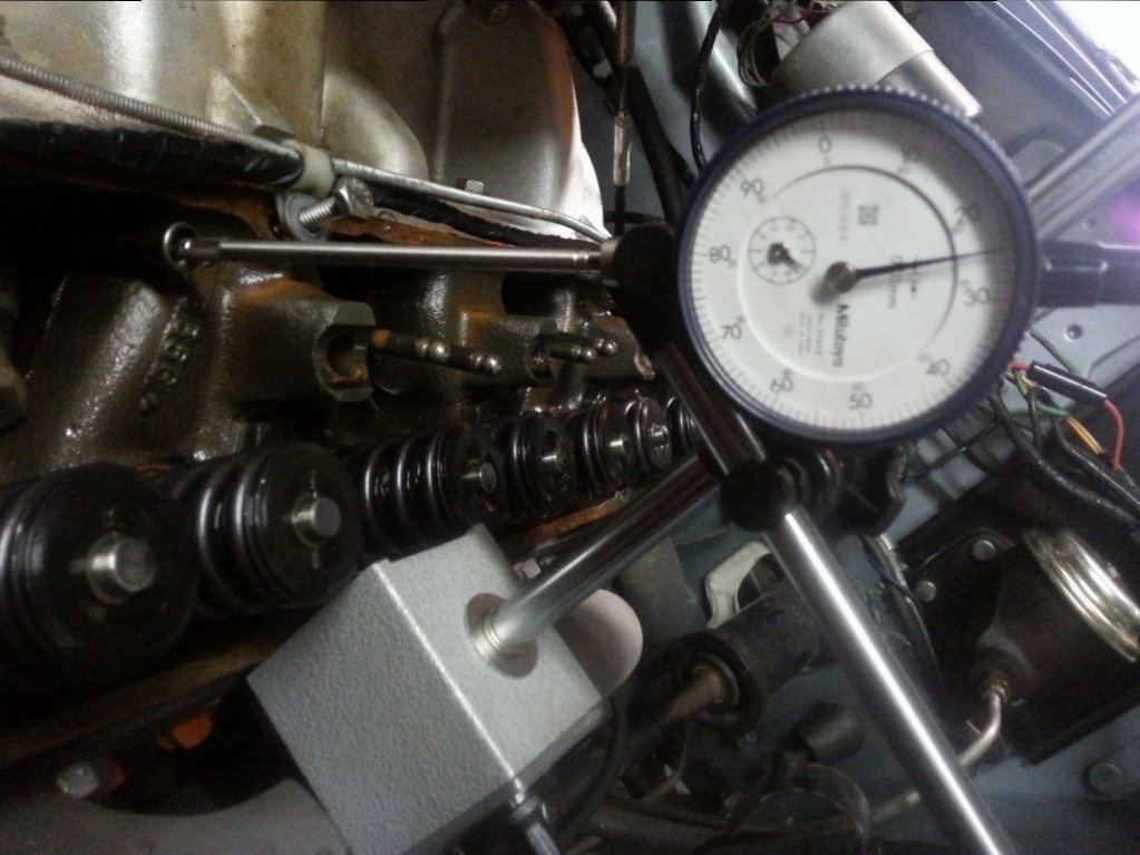

Well I finally found some time to check the camshaft.
I installed a solid lifter and an old slant six pushrod. The pushrod rests in the corner of the intake port to a bolt that lies in the base of the head. Not super accurate but it was the best I could do. With the heads installed I couldn't use a gutted hydraulic lifter with a piece of round bar because it hits the head.
The numbers are as followed:
Total maximum lift is 8,25 mm, or 0,325"
Installed centerline is now at 107 degrees
Duration at 0,050" lift is 247 degrees
I have the original stamped steel rockers. Are they a 1,5 : 1,0 ratio?
Anyone have a clue what it might be, and whether the installed centerline is correct?
Or do I have to measure the exhaust as well to get a more complete picture?

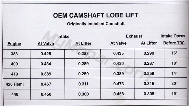

Stock rockers are 1.5...Camshafts and I never really got along all that great,but I would guess one of the "purple shafts"??The smallest of 2 or 3 of the options??? Never tried one myself.

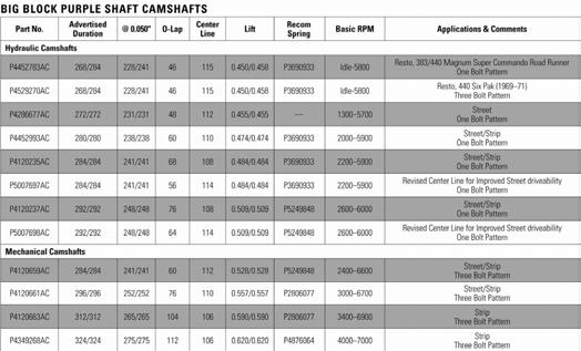

I think the lift I measured is pretty accurate so that would be a 0,484" lift purple cam (according to the previous owner there was some sort of purple cam installed but he couldn't confirm that)
Only the lift @0,050 does not add up. I measured that at 247.
Right...chart telling 241. So, the way it goes, 241@.050 is the suggested set...could mean it's not degreed in right, with the crank. But, I'm no expert. There are others here that know a heck of alot more than I do, telling you for sure, fitting this new crap gas. (Does sound like it's set wrong to me.)

That @.050 setting is fairly critical on cam timing. If it was mine, I'd be pulling the chain cover, and start over. Could easily explain why the motor is falling on it's face!!
