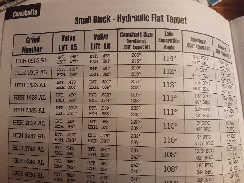

I bought the 62 polara 500 convertible, and with some help found out the 413 is not the original engine, but a numbers matching 361 was in the shed along with other miscellaneous parts. In a box, a brand new cam shaft, hughes engines, part number heh 3228 AL 108° LSA, my question, can't find it online, what's it for? The guy fixed up old chrysler 300s, old 64 65 66 barracuda, and this polara 500.
What's the camshaft for? Thanks.

could be 228-232 duration with 524-540 lift for a small block. heh is hyd and al is small block
Pretty sure the letter " e" designates engle. look for a small yellow cam card. Or take a picture of the end of the rear cam journal.
Done some digging. Pretty sure it's a Hughes small block camshaft.
I used that grind in a 318 oval track engine
like i said in post 5. was not sure because you said 232-228. from Hughes cat
