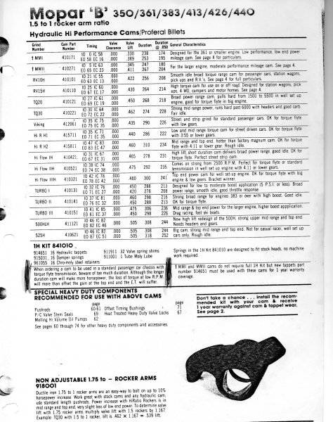

Below is a warning in the Erson cam catalog about excessive duration. The warning is ONLY in the BB Chrys section.
