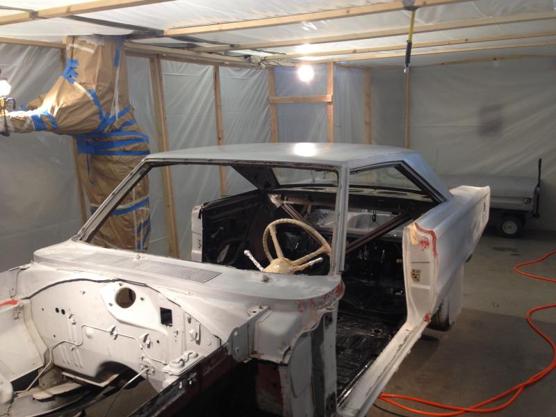

Bob built a homemade paint booth using a wood frame, we covered it with plastic and hung brooder clamp lights (for chickens) as our lights. They cost only $5 each at Walmart.
For ventalation he mounted four box fans on the top of the booth and one huge fan at the bottom of one of the roll up doors in the shop.
We mopped the floor four or five times leaving it slightly damp right before it was time to spray the paint.
We also went over the shop several times thoroughly with the shop-vac to get it as dustless as possible.
Even our dog was shut out of the shop for four or five days prior to painting. (he's not happy)
A couple of dog hairs landing on wet paint could mean a major re-doing of a whole side of a car. No thanks....
But, it all has worked out really, really well!

That's a very clever way to build a spray booth, and the end result looks great. Well done with the painting....now it must be time to start re-assembly. :headbang:
Paint color look great. This is going to look outstanding when it is done. Body looks very solid. Keep us updated on the progress.

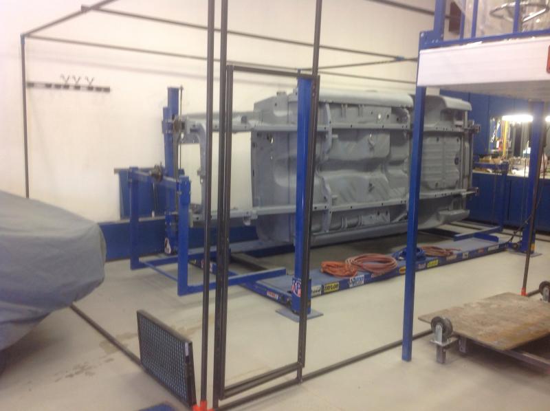

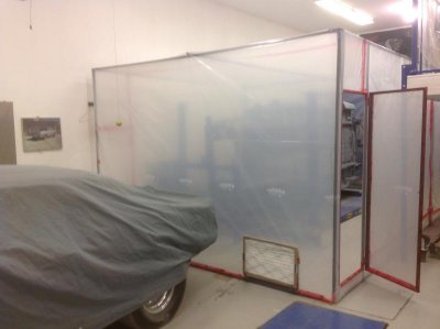

When it comes to home made paint booths, if there's a need and a will a guy can put one together and excellent results with some good preparation.
I built mine out of sq. tubing and it is fully adjustable in size and sets up anywhere.
Great idea!
For us, choosing to go with a wood frame made sense because we plan to use the lumber afterwards for building shelves and a work bench in the shop. Bob's great at building anything with wood and it came together super fast. We considered using PVC or tube steel but, we didn't have the space to store any extra materials when we needed to break it down. Plus, we didn't have but two cars that we planned to paint so this was to be only a very temporary booth.
Like yours though!
