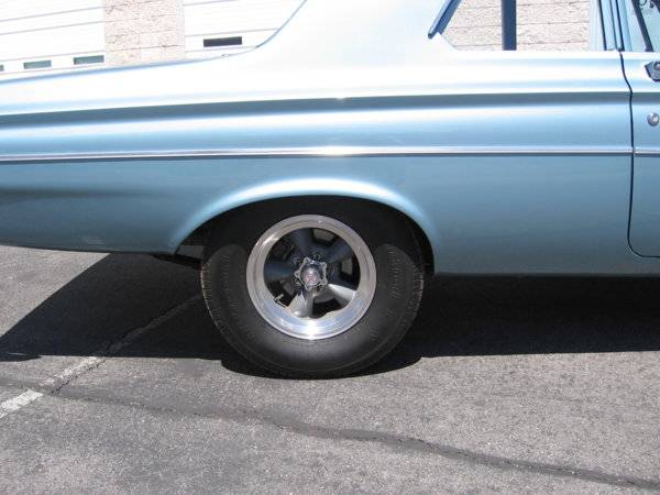

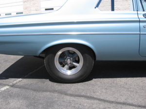

Haven't been on for a while. The last post was last year and involved 65 Coronet not getting gas. Turned out sending unit in tank was bad and came apart and some of it stuck in gas line . Installed new tank ,sending unit and pad between tank and trunk floor. Problem solved . Also finished power steering conversion using borgeson gearbox and rebuilt Federal powering steering pump that came on 440 motors. Had hoses made to connect pump to gearbox. Works great. Looking to install s/s springs in rear. Mopar part #p3690454 and p3690455. Also hanger#p4120079. Has anyone used this setup and is it fairly straight forward ? How much did it raise backend of car ? Lastly looking to install 15x8 steel wheels with 4.50" back space and 28.5x 10" pie crust cheater slicks. Has anyone used this combination and were there any clearance issues ? Looking for S/S look. Thanks for any input.
I went with the 456-457 3400# SS springs on my 65.Car was 3625#ish with me in it. Works well,sits nice.Rear tires are 255/70/15 on 7'' wheels 4'' back space.
You should be ok with your wheel/tire choice.
