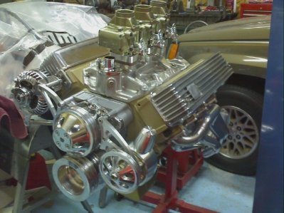

Do what every one else does, put a boring 440 in it and play follow the leader. Forget doing anything with that Poly, I don't want anyone having an engine like mine..I want mine to be unique so go with that 440..that Poly is a dog, throw it away..
Can you spell phefus, fesus. pheafesus? fe???????

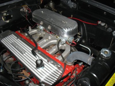

That's a nice poly..........I put a 225 slant in mine with edelbrock 2X2.
^^^^^^^ Yep.Can't beat a good ol' Slant !!
