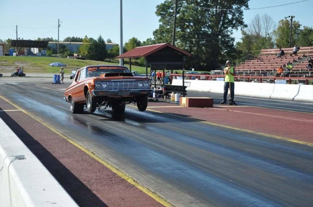

I used tubular upper control arms with hiem joints. Also made a bronze lower control arm bushing. You have to come up with a way to hold the LCA in place as the metal bushing won't hold it like the factory one. This really freed up the front end. It was a drag race only car. 1.21 sixty foot. Definitely would not recommend this for a street car. For safety and comfort reasons
Most drag cars seperate to quick in the front anyway. Unless your running a stocker or something on very small tires the stock bushings are fine. Use the Moog offsets in the front upper a arm to gain caster. I run stock a arms on my 64. Been 1.240 60 ft.

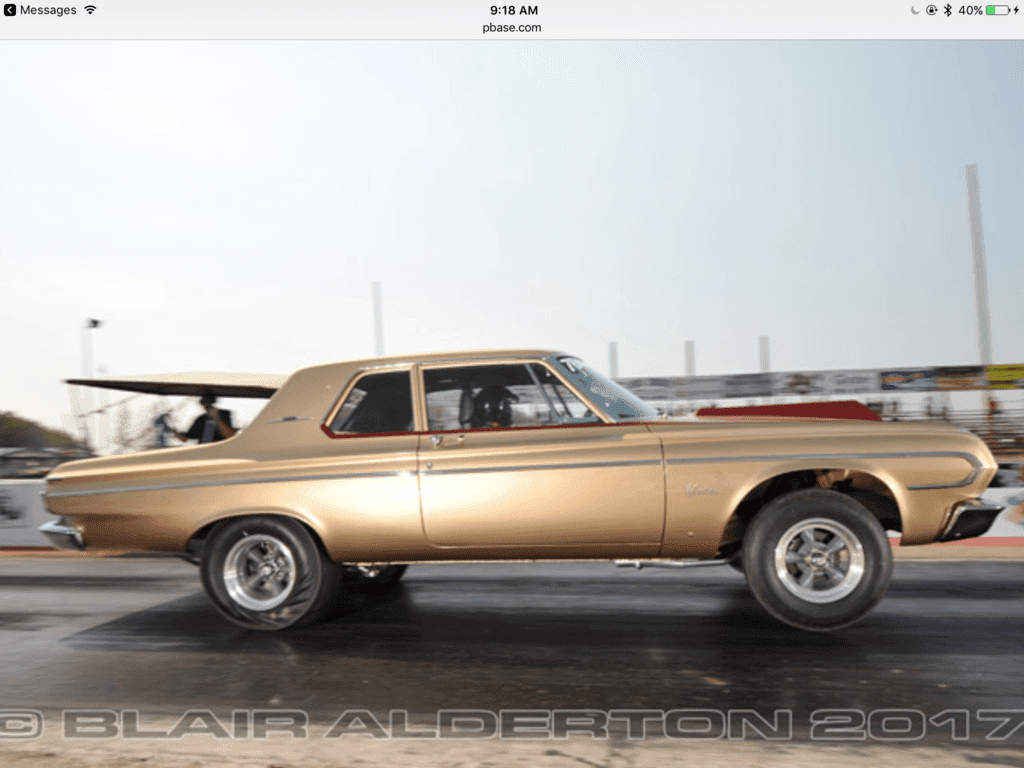

Even with a stocker they can come up to quick and unload. However added travel will help.

A while back I was looking at switching to tubular upper control arms but left the stock ones in with the offset bushings as per Doug's advise. Since then I've been tightening on the front shock rebound to slow the separation. Saved me $$.
