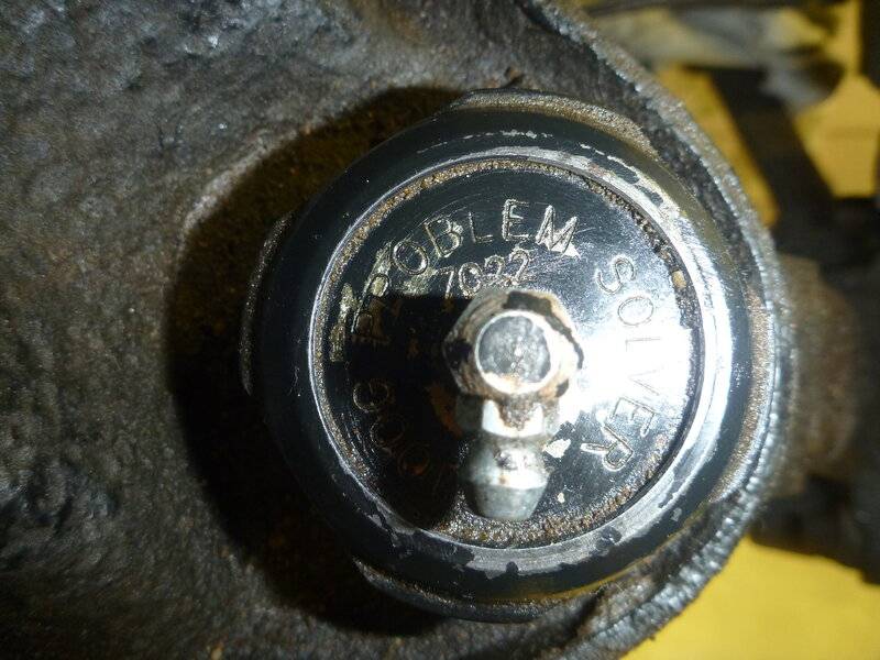

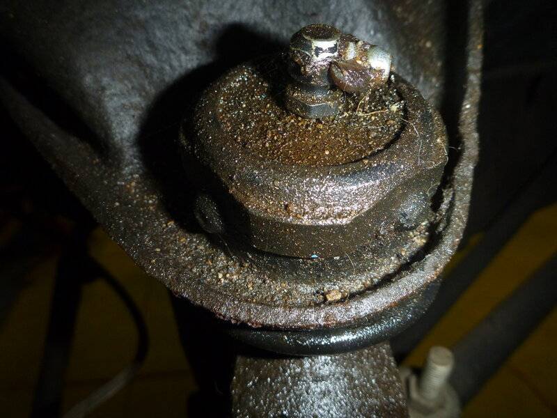

Even if the threads are stripped, you can buy a "Problem Solver" from Moog with the retainer snap ring and also tack it in place. (the one shown is small stud for an A body.. so don't go ordering off the number on this one)

Also be careful as the threaded BJ and arm was replaced at some point with a pressed in version.
There has been some debate about when this actually took place.
it is hard to tell which is which without the BJ removed.
Other than the screw/press difference, they interchange.

My UCA ball joint was cross threaded when I took it apart, I just tacked the new one in place and it's fine.
I've tacked welded a few too....but I like to make sure the fit is at least half way decent. I do some crazy stuff with my cars but having a ball joint separate or plain fail isn't exactly a fun ride so I like to make sure as much as possible that's not going to happen.
