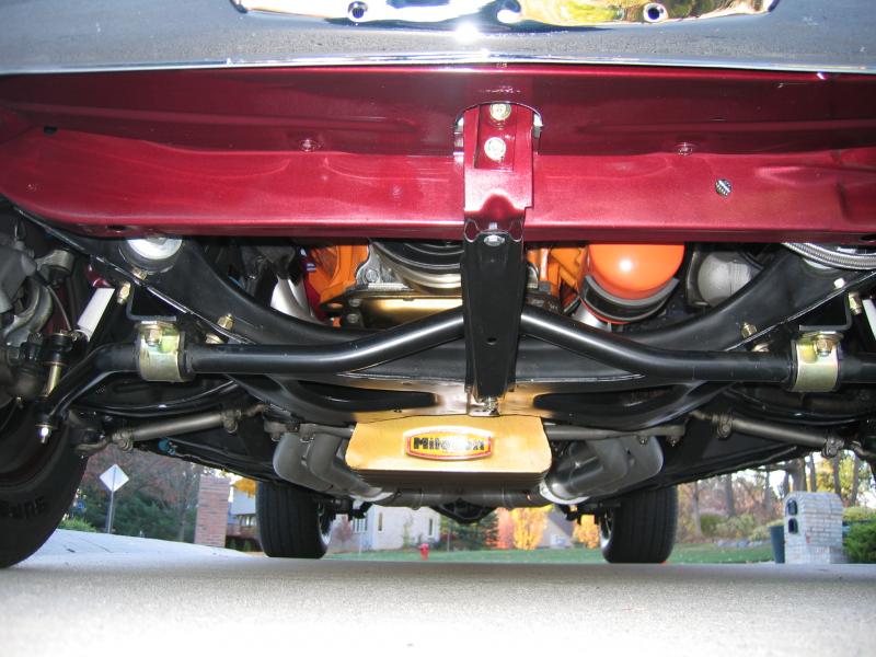

I too, have the Magnum Force double adjustable upper control arms--absolutely love the added caster. JUST A SUGGESTION: Ride in someone's car equipped with polyurethane bushings before you convert yours. I converted to poly bushings and got real tired of the constant thumping with every pavement seam--being that my car is 99% street driven, I took the entire front apart (for the second time) over last winter and installed original OEM rubber bushings--WHAT A PLEASANT CHANGE!
