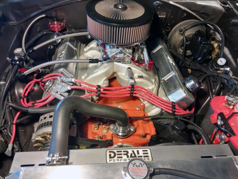

Hey man,
I am using a Goodyear hose here:http://www.summitracing.com/parts/GTR-60664
If you cross reference your Gates number to the Goodyear number it says: Not exact match
Gates cross reference here: http://www.gates.com/all-search-tools/automotive-interchange-search-results
The Goodyear hose looks and fits great on my 440
Here's a pic of the Goodyear hose:
