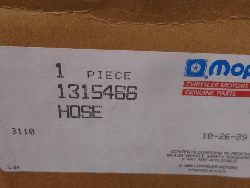

Who sells good repop heater hose? Few other hose questions too

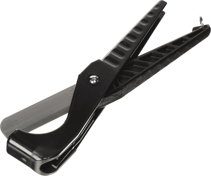

Also what is the best way to cut radiator hose squarely? I have Gates cut to fit hoses coming for that. Don’t want to chance a problem on the bigger hoses at all.

I guess I have never bought repop heater hoses but I can't see why they wouldn't fit properly. Most Mopars use 5/8" hose, some use 3/4" as well. Mega Parts USA has coded heater hose.
Cutting radiator hose squarely can be a bit tricky. You can use a hack saw carefully. They do make hose cutters like the Gates #91143 but you have to smash the hose flat to cut it and often the blade isn't long enough to cut completely through the hose.

I use the cutter shown above. If you need to cut off 2 inches of hose you can cut one inch off first to practice and see what works to make a straight cut.

I’m thinking of trying to get a pipe into the hose and cut with a razor. Just a thought at this point. I figure as was posted a cutter would smash it flat and be hard to get square.

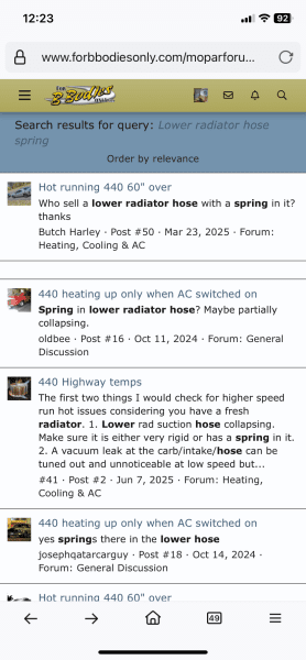

Rockauto doesn’t list a spring. Is there a good source for these?
The search function on this site is your friend. Many posts about this. The first post gives a source from a Ford Mustang site, which is where I ordered mine. The spring for the lower hose. TMM
