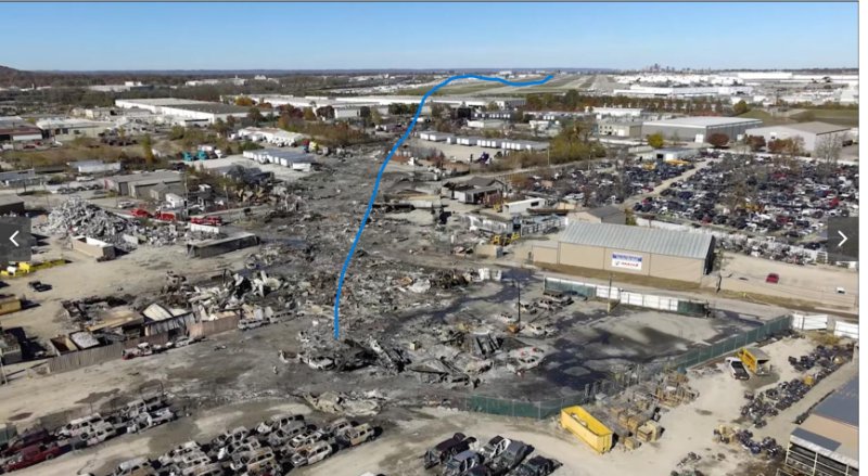

The engine detached from the plane smoldering on the side of the runway.
I saw a video on TV, of the left wing,There is video of it before it hit. Appeared that maybe the center engine over the tail was on fire.
