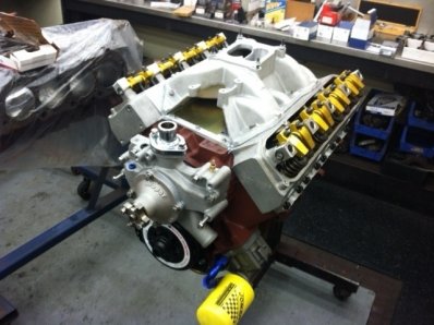

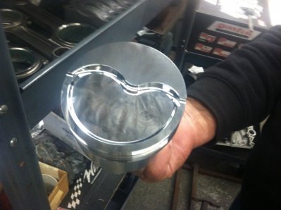

I`ve built engines with used pistons before but only if they measure good and are not scuffed up or collapsed. Usually they are a few tenths out from each other and that can mean it takes more time to hone the block. Pins need to be checked along with the rods. If they are pressed pins it becomes an issue to balance them. It can be risky to press the pins out sometimes. I recently had a guy come in for a balance job and he had a used set of pistons. Dyno time only he was told. That may have been true but one piston was a replacement and was nine grams light. I did get the numbers I was looking for but it was a lot more work. In this case he should have left them where he found them! It can be a crap shoot but it can work out too. Just some things to think about when considering used parts.
