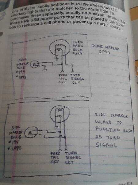

Im pretty sure you will need a dual filament socket and bulb to get that to work with still having a marker light functional.
There is a way to do this easily, i had a schematic for this, i will look for it tomorrow and if i can locate it i will post it.
Here you go
