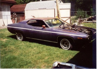

This is what my 71 looked like before restoration..I can not find what the V6 stripe was supposed to look like, or if this is a correct stripe...RandyJanuary 3, 2002.jpg
Please refer to the picture I posted of my car..I'm trying to figure out if this is correct, and if it is, where I can find it...Thanks
That is not a factory stripe.
A V6 stripe will be found only on a Satellite Sebring +
If you own a SSP+, 71Charger_Fan posted a picture of the V6 stripe.
If you do not own a SSP+ then a V6 stripe is not correct for your car.
Definitely not a "correct" stripe in your photo.
Questionable color as well, without more tag info.
I'll offer a "2nd" voucher for 69Coronetrt knowing his stuff.
