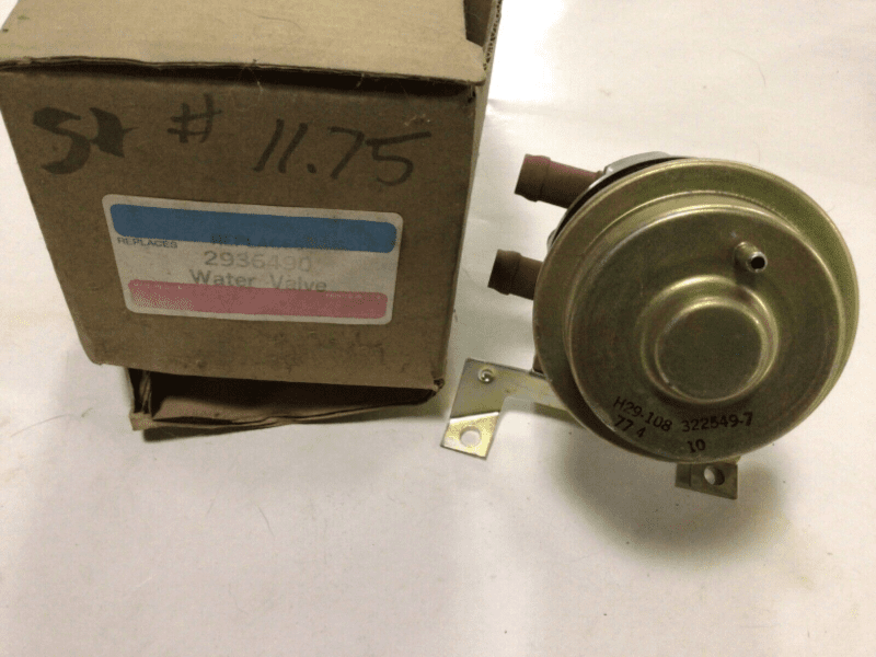

look under battery tray and see if it there. Do you have a heater water valve?
I will look under the battery tray tomorrow. I do have a water valve, had it rebuilt. It does not have a actuator on it as the one shown in your pic. Thanks much!
