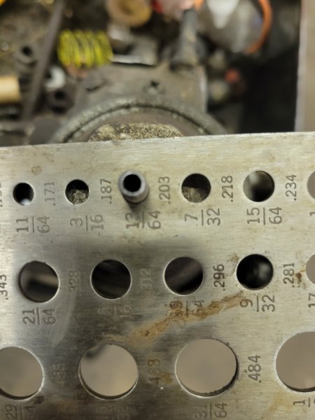

Think it's more like 1/8" I.D. Similar to wiper fluid hose. I have purchased it at Advanced Auto Parts.
There you go! 3/16 sounds good
Edit; checked with some drill bits on a hose, 5/32nds might be a better choice

its 3/16. Make sure it is designed for vacuum, not pressure or it will collapse.
