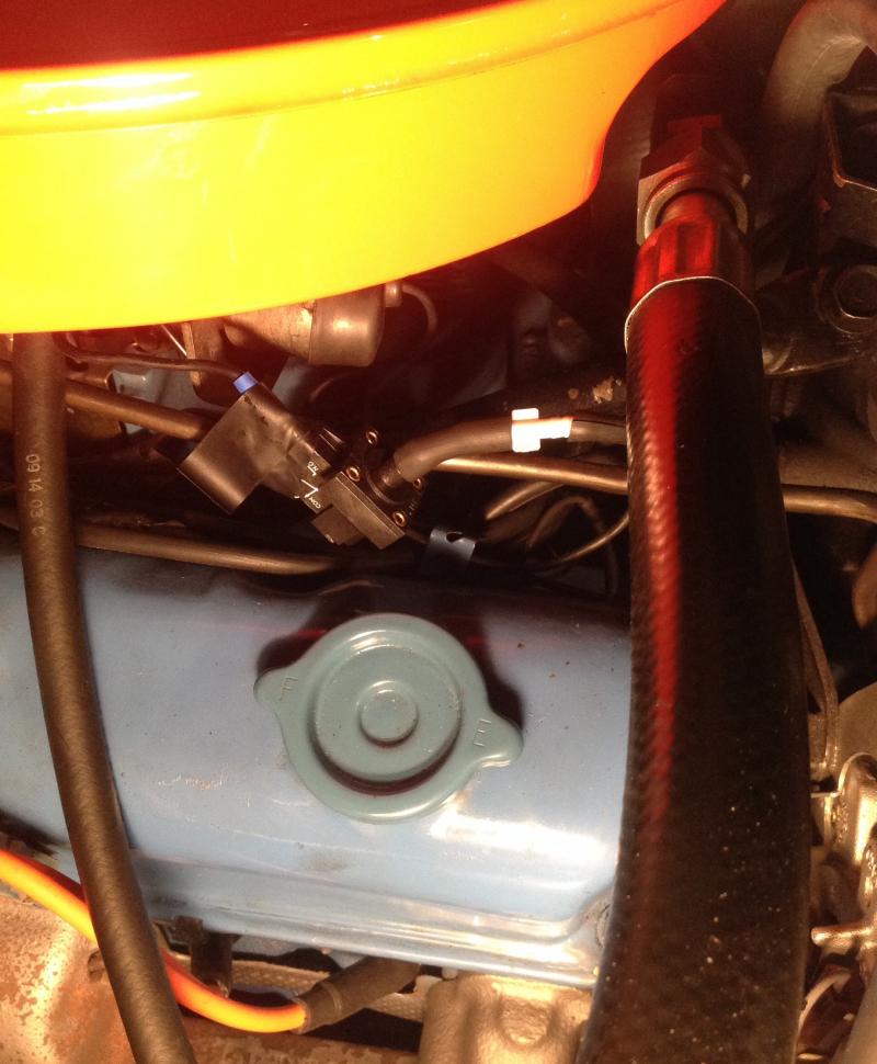

I noticed that even with the raised compression and greater lift cam, my 73 340 was dragging a bit with the A/C on.
So, I took a clue from some modern cars and just installed an adjustable vacuum switch in line with the compressor clutch power lead.
The switch is available with adjustable vacuum actuation from about 5 to 25 psi according to my vacuum gauge.
It works great except that it was engaging the compressor too soon with my initial setting at 5 psi so I adjusted it to 8 psi to come off a little sooner.
The second problem I noticed was that the switch was trying to re-engage the compressor too soon while I was still at high rpm ( over 3000). This was causing slipping of the compressor clutch due to the still high head pressure in the compressor and the higher rpm that was restoring vacuum to the switch.
That's where the car's OSAC valve came in to play. Rather than connecting directly to engine vacuum, I connected it to the OSAC valve which is basically a vacuum restrictor to delay the build up of vacuum to the distributed advance. This worked great at the 10 psi setting of the switch and gives the compressor a chance to engage without slipping at around 1500 rpm when vacuum builds through the valve enough to reactive the the switch.
I forget to turn off the a/c switch when I shut down. So, an added benefit was that this switch automatically allows me to restart the engine without the drain on the electrical and starter of the a/c engaged at immediate start up; hot or cold.
Im planning to make up a mounting bracket to go on the intake manifold to clean up the install and keep the stock look.
I found the switch on ebay. Here's the link if interested.

this should be Inchs not pounds
and controlling your AC is good
So, I am curious what your compression and lift are on your 340? I have upgraded my 340 to 9.4:1 compression and cam with 454/480 lift. Also, I am using the bigger 6322 Thermoquad and not the original 6319 thermoquad. The other difference is my distributor is setup for mechanical only advance. I am rebuilding my original AC system for R134a, so when I get it back and on the car will be interesting to see if I get the same issue you are seeing.

You are correct! My bad.... I know better.
But you have to admit, inches of liquid metal in glass tube to creat a vacuum is a funny way to measure anything but ambient air pressure.

Running vacuum; cold and full warmed up. Ill be checking vacuum on my engine tomorrow. Still tinkering with the vacuum switch.
