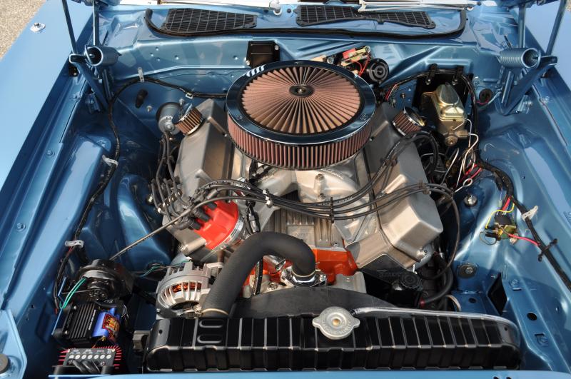

I use this Mallory electronic dist and these valve covers I bought from Mancini with my basic Indy EZ heads. The pic makes it look closer then it is as it has a good 1/8" or a tad more of room. The dist does not touch the head or valve cover at all but it is close as like I said it gets about as close as 1/8" but no closer anywhere and it does not touch. As for the valver covers I had no problems just bolting these on using these EZ heads and Mancini billet aluminum valve covers. And never no leaks with the reuseable Moroso blue valve cover gaskets. Ron

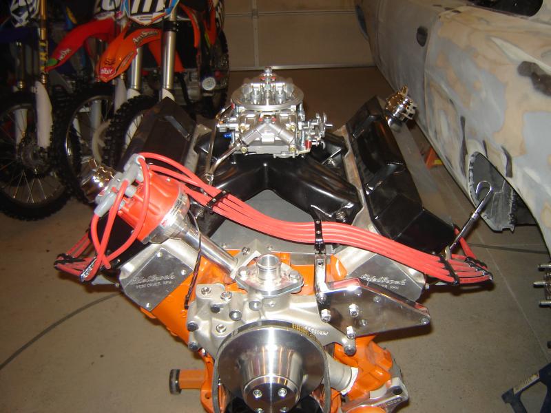

Here is another eng pic to help give you an idea how high my Mallory dist sits in relation to an MSD unit. Ron

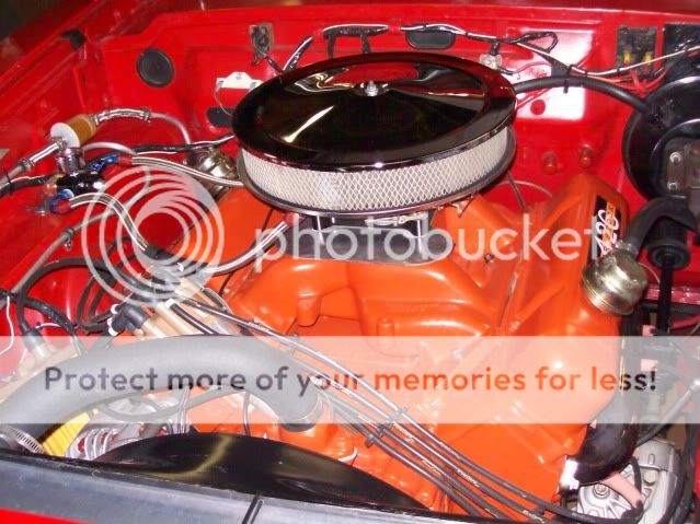

FireCore distrib, mopar performance cast valve covers

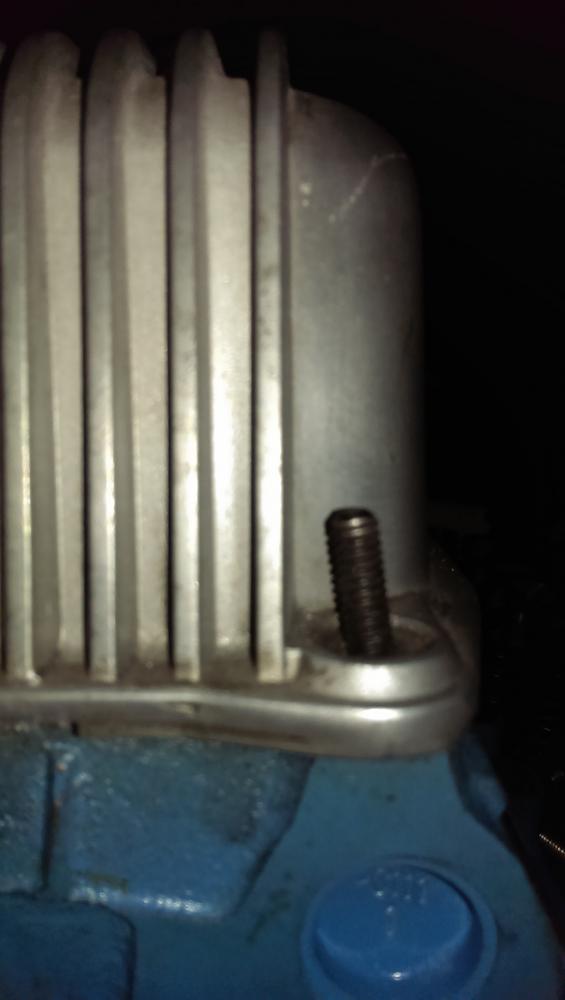

This is what Mike is talking about. I wanted to ask the same question. What do you do in this situation for hardware? I never noticed it on factory valve covers. What's the difference between the two?

Exactly what I was talking about. I think I have learned that OEM IRON HEADS have the bolt hole threads "angled" and the ALUMINUM AFTERMARKET HEADS have the holes threaded "straight" out of the heads.
Most of the fabricated Aluminum Valve Covers are set up for Aluminum Heads with the "straight" bolt holes.
But....before ordering any valve covers make sure you are getting ones that fit either IRON stock heads OR Aluminum Heads to match your heads.

Now that I think about it a little more, I have had stock iron heads with VC bolt holes not drilled "straight". Don't recall all like that though. Not a problem with bolts since they just contact the VC at a slight angle, which could be cause some leakage problems & over tightening. Clearance on the RPM head with my iron tach drive Hemi distributor is REALLY close, but it does clear.
