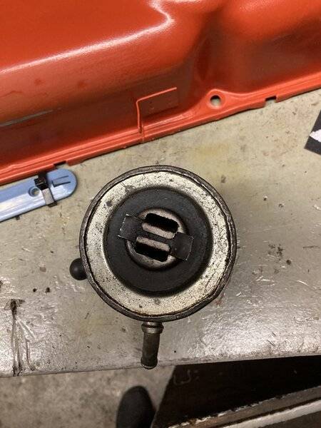

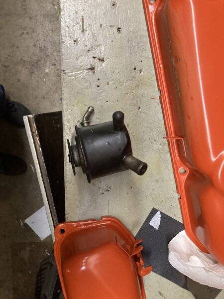

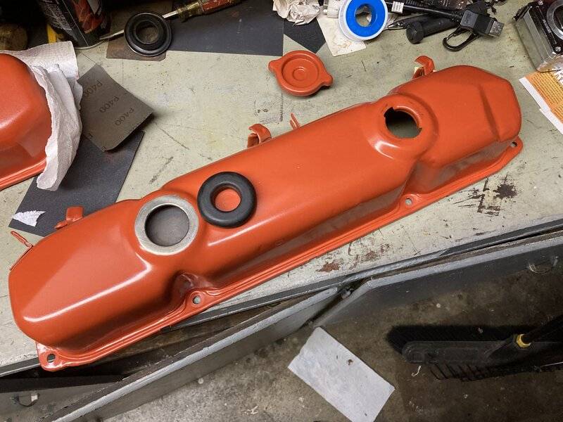

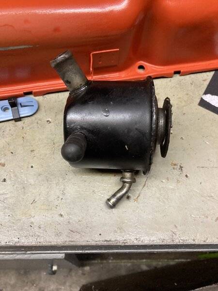

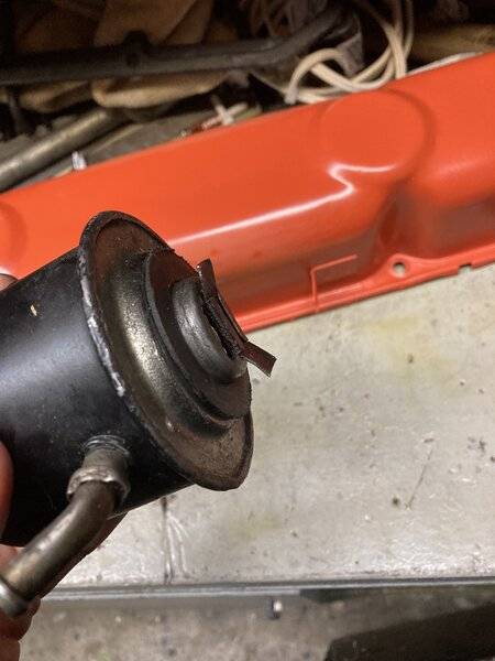

I believe I have the correct valve covers for my 71 440 Charger but not clear how the breather is mounted? And do I have the correct rubber grommet?
I know it goes on passenger side.
maybe wrong grommet?
Any help is appreciated.

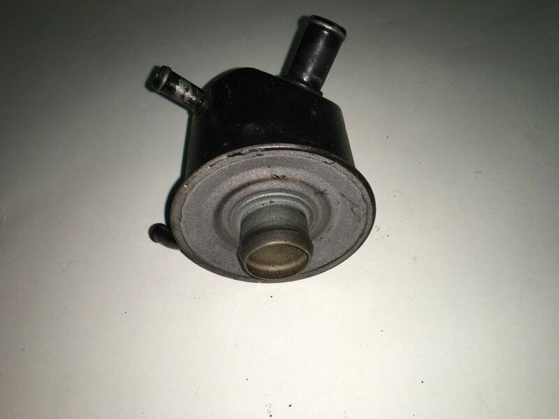

Bottom of breather should look like this
That one screws into the valve cover directly like in place of the spot where the oil goes in.
