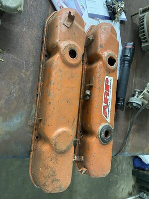

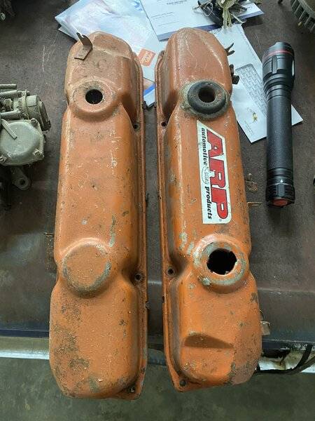

I have a set of big block valve covers in storage for years and I’m trying to figure out what year they are. Any help is appreciated
ADFE1DBE-D84F-4676-8CC3-BDBDF878782C.jpeg 8696A819-1E8C-4D2E-8F40-B289A0ACCAAC.jpeg
They are 1971, the passenger side (one with two openings) can be passenger car or HP but the driver side due to that extra wire holder at rear tells me NON HP.
