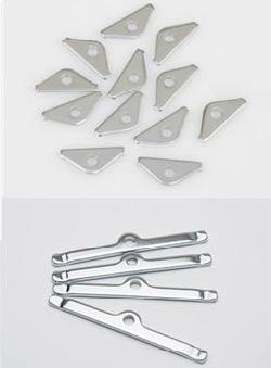

factory 440 v/c are a bitch, I cut some little triangles of sheet steel and weld them in, but you can just grind some large washers to fit in there and not weld them, I fit the little triangles in and then repaint everything its hard to tell they have been changed.

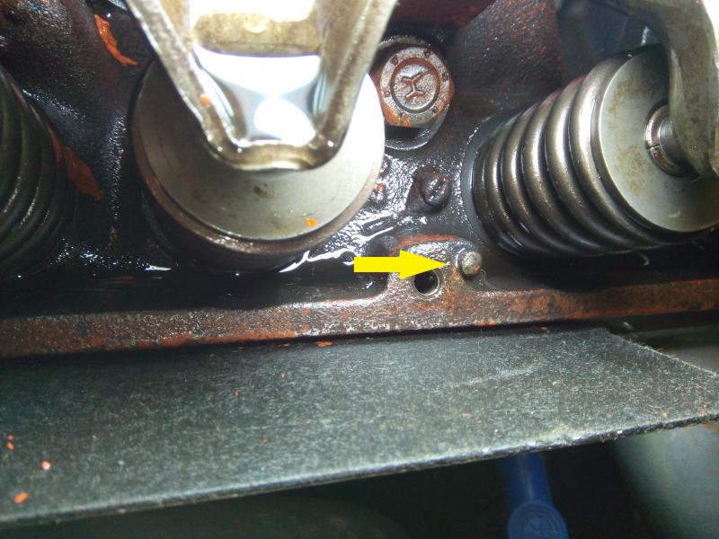

Did someone say casting flaw? I made a career out of stopping my aluminum fabricated VC from leaking. I overtightened in the pursuit of stopping the leaks, bent the VC, had them plained. In the bitter end I found a casting flaw. I ground it down and I put 'The Right Stuff' sealant on the gasket and a little on the bolts for insurance. No more leaks.

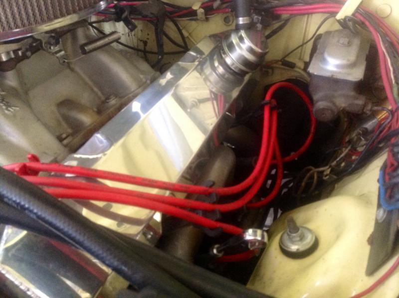

These leaked at the drivers firewall. Took months to figure it out. I'd prefer the factory look. Suggestions? I gave mine up because they were for a 70 and traded for these. You need a thimble to add oil and they look scratched like **** most of the time. image.jpg

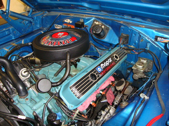

if I dont use the stamped ones, I rock my V/C's from Leanna...aka Cuda Chick :headbang:
