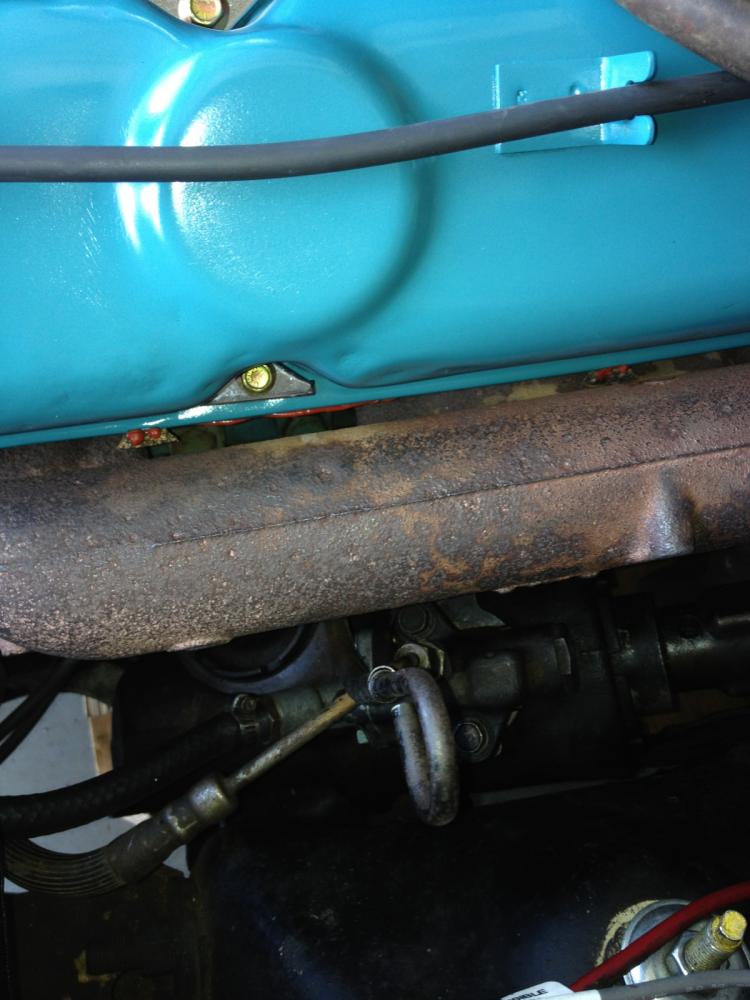

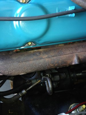

So the new steel vc have been ordered.Went the Home depot today and bought 1/4-20 x 3/4 inch stainless steel bolts from them with bonded sealing washers.I hope these will help seal the v c's. Ill check you guys updated.
New coves are in with sealed washers,cork gaskets with gasket sealer adhesive spray.Gonna start it up next week.ill keep u guys updated on how is looks aka leaks.
That's exactly how I did it, Fel-pro cork gaskets with a 1/8" bead of red RTV on the valve cover side only (to help out with less-than perfect 40-yr old covers). After a good 20 hr cure I took it for a hard run and they appear to be holding. No seepage.
Time will tell how the red RTV holds up to oil, some prefer Ultra black or the Right Stuff for a faster cure.

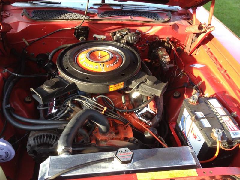

I have a set of powder coated aluminum Mickey Thompson valve covers. Used the Felpro cork gaskets, but did not use any rtv. Used Permatex "Indian Head" shellac to hold the gaskets in place on the covers before setting on the heads. Let everything set up nicely before placing/tightening. I don't recall the pounds recommended for tightening mine down, but 40 pounds seems high. Not had any leaks all summer. -- 74 Charger with 71 440 4bbl --
I
I like your pic..... The Blue Top, I have been there a few times this summer.
