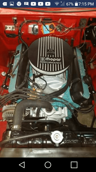

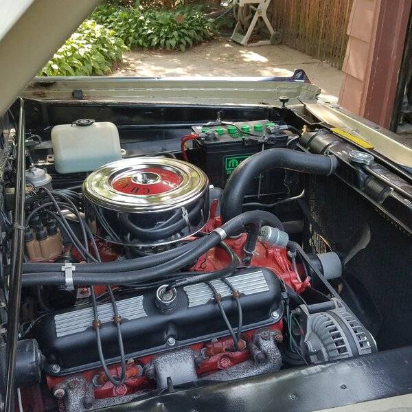

X3 or more for Leanna. Her work is superb! My covers were really messed up and she made them look over the top, better than new. About 15 years later after taking them off many times to adjust solid lifters they are still like new! (last photo)
