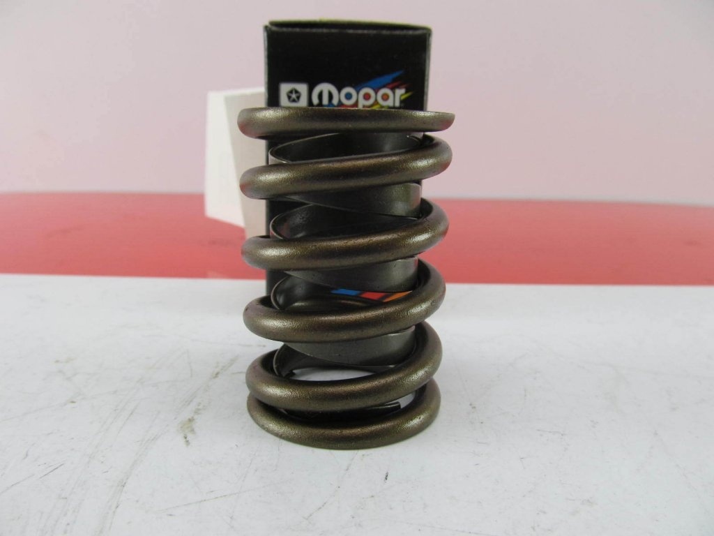

MP #5249848 are listed at Max lift .540" list with spring 1.86" height.
Eddie RPM heads come with a spring rated at Max .580" lift and 1.46" height.
Have you found these Edelbrock springs to be sufficient?

i don't think i'd use either of those two springs with a roller. good chance the lift at the valve will be greater than the cams advertised lift numbers due to rocker ratio. i'd run the spring lunati recommends.

So then, like I said over on ABodies, if those heads have the original 5845 Edelbrock springs, then you are good to go with either the '12 or '13 camshaft.
