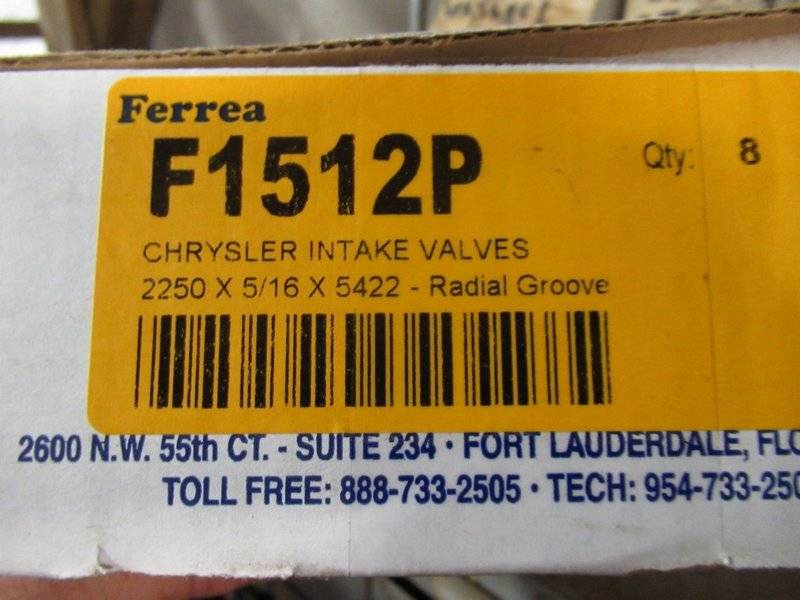

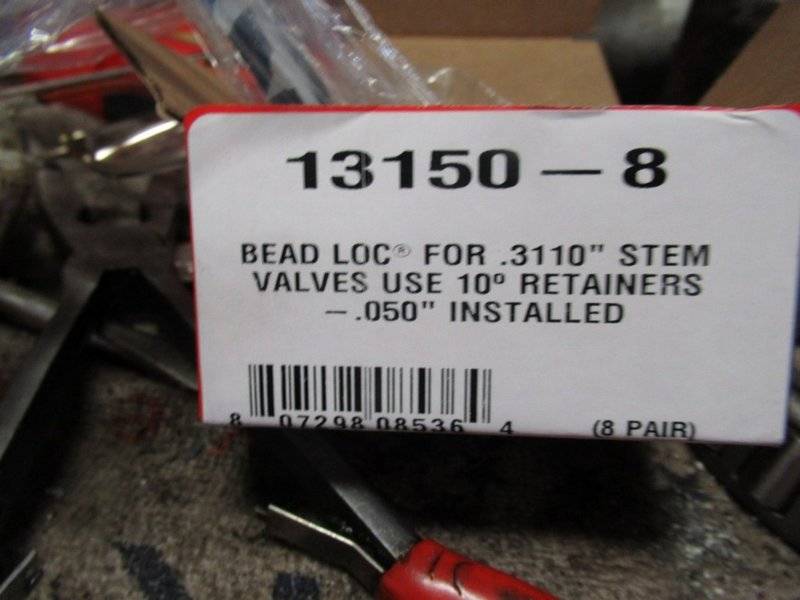

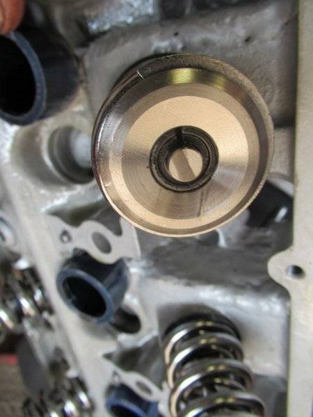

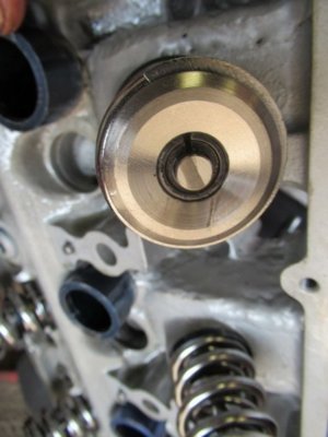

Now they have a new style lock:realcrazy:
