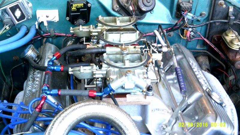

old set up, with the iron heads
it still had a choke stove & the factory heat crossover
MP Alum 6bbl intake
& stock style steel 6bbl fuel lines, except from the reg to carbs
& that line was wrapped with DEI heat shield
had a Carter 8psi mechanical org.
(Holley 8.5psi hi-volume 180gph, after the Carter died)
I added an Aeromotive SS 14psi 175gph electric fuel pump
& big canister with a replaceable filter back by the tank
AN stuff between them
I just wrapped the incoming carbs fuel lines from the bypass reg
to help with heat soak
& a bypass line going back to the tank, keep the fuel constantly flowing & cool
even in 100*+ heat
this old street/strip setup was nowhere near
the 'heat & HP' of the new set-up, can produce
& up at altitudes, all the issues, are all compounded/worse
I was doing preventative measures even back then
new stuff I don't like the look of fuel lines as much
sort of busy
Also I went/switched to Edelbrock RPM Alum. Heads (mildly ported)
they have no heat crossover
but it (AN stuff) cured any & all fuel heat issues & starvation at high RPM too
Added phenolic spacers (I went 1" but don't need that much)
I don't have any hood clearance issues, some may have
it's a low-deck & has an A12 liftoff hood
AN lines/fittings & thick Russell (Armorgaurd ? from like 2007) #6 AN Hose
not ever even a hint of vapor lock, NOW
I had to sacraficed the choke stove rod/connection
I don't really need it here anyway (may make a new one sometime later)
lines DEI wrapped where near, any heat source
(granted for an all-OE look, you can't do it, that's someone else's issue)
I did most of it on this specific combo back in 2016
no heat-soak or vapor-lock ever anymore,
even with the crappy summer fuel blends, lots of (corn liquor) 'ethynol content' 91 oct.
even driving at 7,000+ altitudes, where all the problems are compounded
My intake temps are in the 110*-120* range, after driving, not 200*+ & then heat-soaking
Grant you, I have an electric 35gph water-pump & it's in an Edelbrock alum. housing
I use Purple Ice in the radiator (water wetter type additives) & 50% antifreeze Bee-Cool
almost no heat off the rad. hoses,
from a 3 core large tube down flow, thicker custom 22" Alum. radiator
& 2) Perma Cool alum. blade electric fans,
everything ran thru relays fuses & arming switches
1) 16" 3,500cfm puller, in a custom shroud, it does the main job
& 1) 13" 2,950cfm pusher "just in case"... I rarely ever even turned it on
It runs at like 180* even in 100*+ Calif. summer days (it can get to 110* up here)
unless I'm hammering it hard :poke:
then it gets to just under 200* (maybe) & I can turn on the pusher fan,
cool it back down fast
I know my style of build, isn't like most here (I know it looks a lil' busy too)
but it works, works great, especially on my "thermal nuclear underhood heat device"
big HP makes big heat, you have to combat it in someway
& take precautions too
I know I went overboard,
but it never does that heat-soak crap or vapor lock 'ever'
I absolutely hate that ****, and refuse to succumb to it, 'ever'...
it really likes the fresh cool air coming in that A12 scoop,
thru the 3" K&N filter so it can breathe too
your results may vary

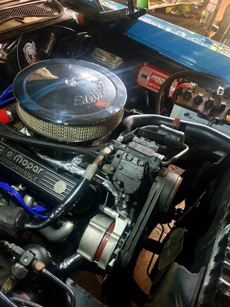

Probably not, but it's dying for some reason when driving. Driving mine, car died after backing off to go through an S turn and with some coaxing I managed to restart it and we actually cruised for 40 miles after that and made it home. In this condition it was still pumping gas. Parked it and wouldn't start again, period. Tore it apart to find a piece of diaphram jammed the check valve open.
I've just never seen a car die from vapour lock when on the move! Stuck carb floats flooding an engine YES, fuel pumps dying YES, Ignition systems overheating and crapping out YES, vapour lock Never.
I suppose it's possible. I've got a newish mechanical pump on the shelf I could throw on easy enough.

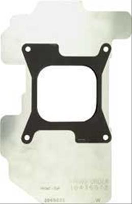

Below all are from Summit Racing, right click on the photos it has part #s
all are for square-bore patterns (Holley Carter Edelbrock/Webber)

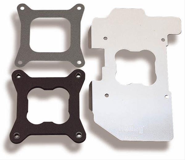

Holley sells a couple different styles, thin one like $42
another like $44 .250 in. gasket & shield

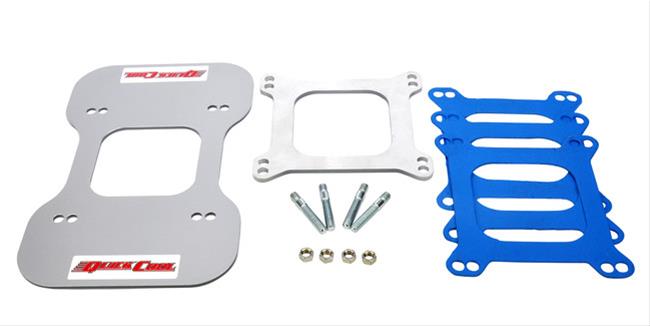

Quickfuel sells one too a bit 'more $$' $114 'Heat Insulation kit'
more $$ for the fancy name
comes with a thin spacer, square-bore pattern pan & gaskets needed

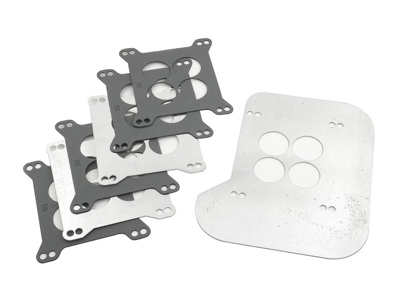

Mr. Gasket does too like $44
