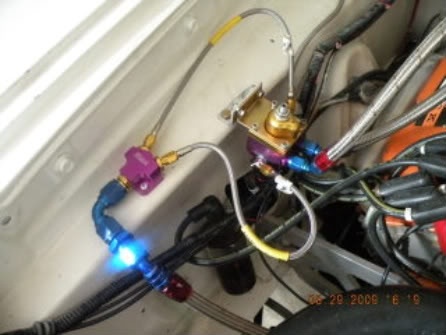

return line or use a factory style vapor separator in conjunction with a return line.

I run a fuel return back to the cell, keeps your fuel cool

I run a fuel return & a non metal carb spacer, air temp gets over 100 deg down here in Southeast Texas, my car is 68 Charger 512ci, COLD AC & has no vapor or boiling fuel problems
