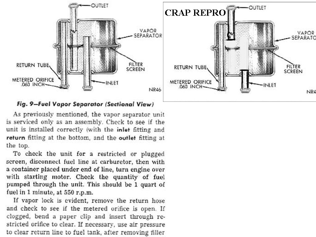

You'll want to read this discussion over on the A12 forum. There are crap separators out there (see 3rd post on pg 1, or picture below). Alternatively, Wix makes separators also with different outlet sizes. See Pg 4 of this discussion.
http://a12mopar.com/yabb/YaBB.pl?num=1324606912/0
