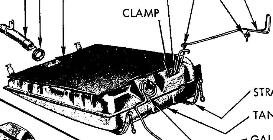

My '69 Road Runner has the original cap, non-vented. Tank vent comes up through the trunk and back out the bottom. (upper right hand corner)
I know for a fact his Belev vents threw the filler neck and has a vented cap if it is still of factory configuration. Doesn't matter how any other models vent.
