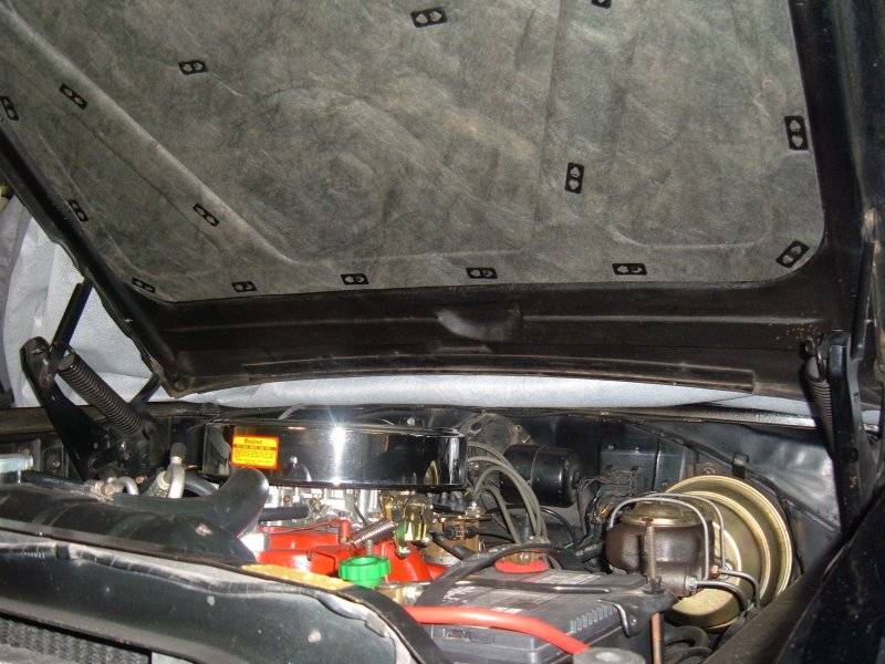

My 383 in 65 Belvedere with carb spacer and flat air cleaner had interference with the under hood insulation. I switched to a drop base air cleaner and no interference.

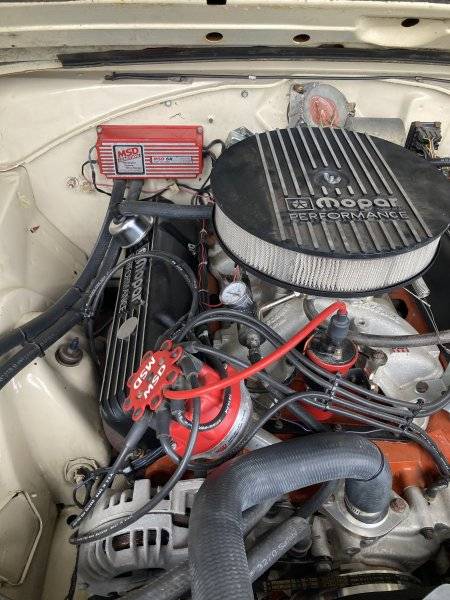

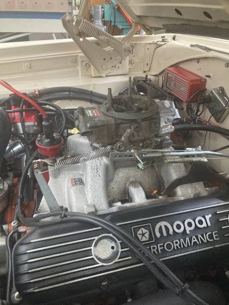

Ok. Not seeing that unit, but do see others. Saw one base, MRE28170, that may be it. The others shown are formed to fit the center hung bowl Holley's. You might look into finding a shorter element. I believe the one on my MP unit is a Wix 42044. It's a little under 3". Maybe 2.750 or 2.625? Can verify. Do you have a picture of your base? Wondering if it drops enough. Of course none of this helps with the vapor lock, but the other might.

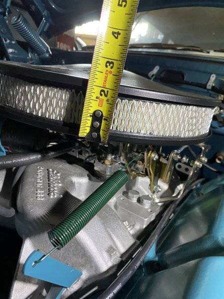

The air cleaner is dropped down. Any lower and it will interfere with linkage. You can make out the impression in the hood mat.

Yeah, you may be stuck there. Only other thing to check would be to try and find a shorter element. There are dimensions in the back of the filter catalogs. But...need to find a catalog which is almost non existent in many stores and someone who's willing to go through all the dimensions. Any old school parts stores in your area? Is there a Wix/Fram/Purolator etc number on it somewhere?

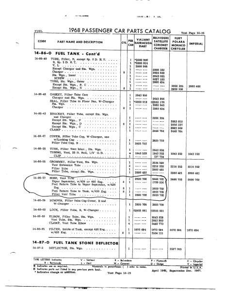

Mopar engineers figured out many years ago the biggest problem with fuel boiling after shut-down was in the fuel pump, not the Carb. That was why they developed the fuel separator and return line and installed it at the fuel pump. The expanded fuel gets sent back to the tank thereby leaving the fuel source to the carb uninhibited.
