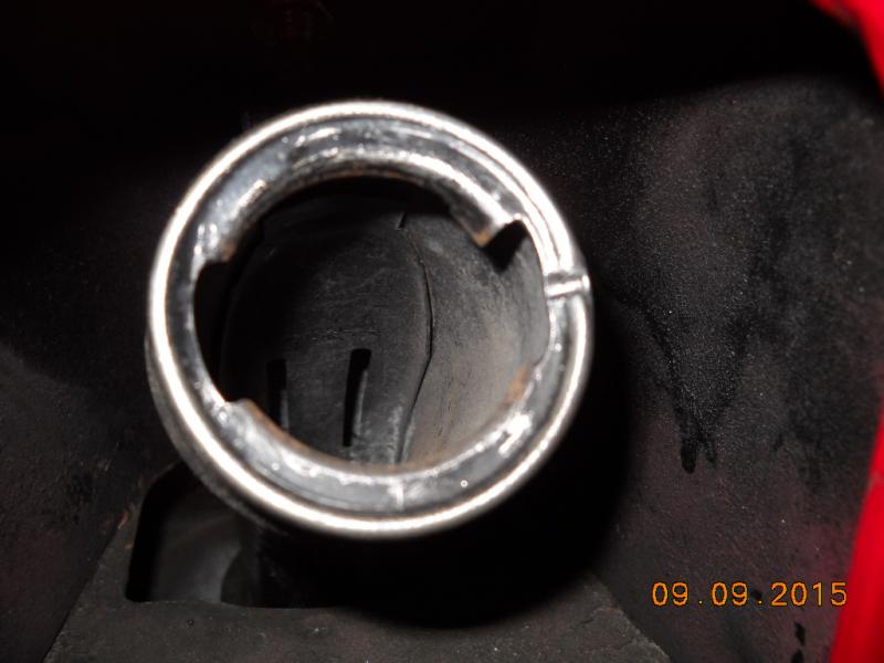

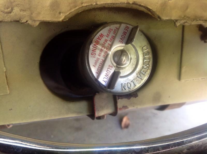

take the gas cap off and look at the filler tube. if it has a small groove where the cap seals then it will use a non vented cap. my '65 coronet uses a non vented cap.

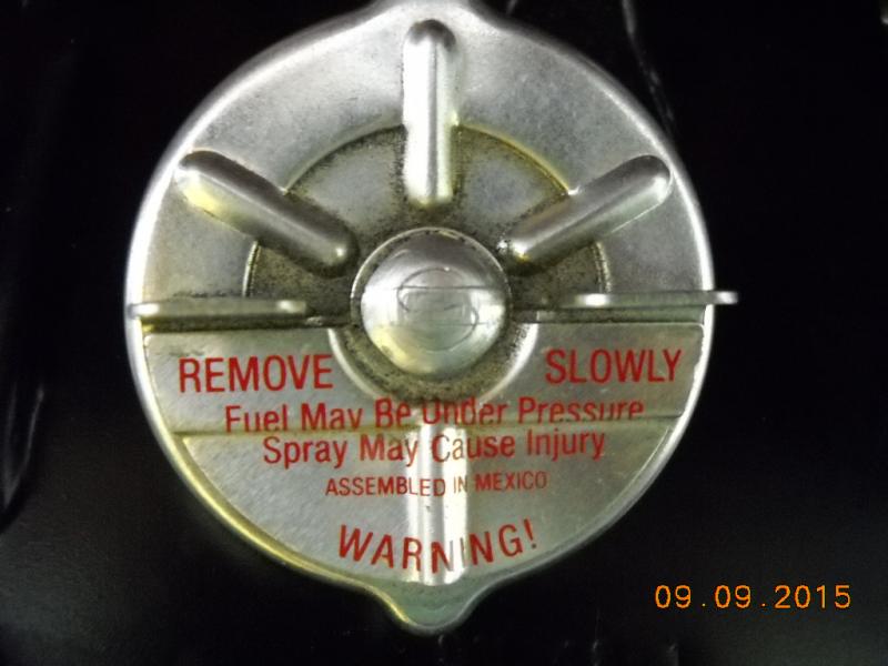

Here's my 63 Fury set-up. Like Doug said, the filler neck should have a notch (right side at 3:00 position on picture) that vents the tank. Easiest way is to buy one from NAPA or rockauto.com for YOUR car.
