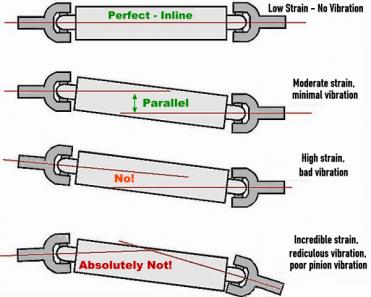

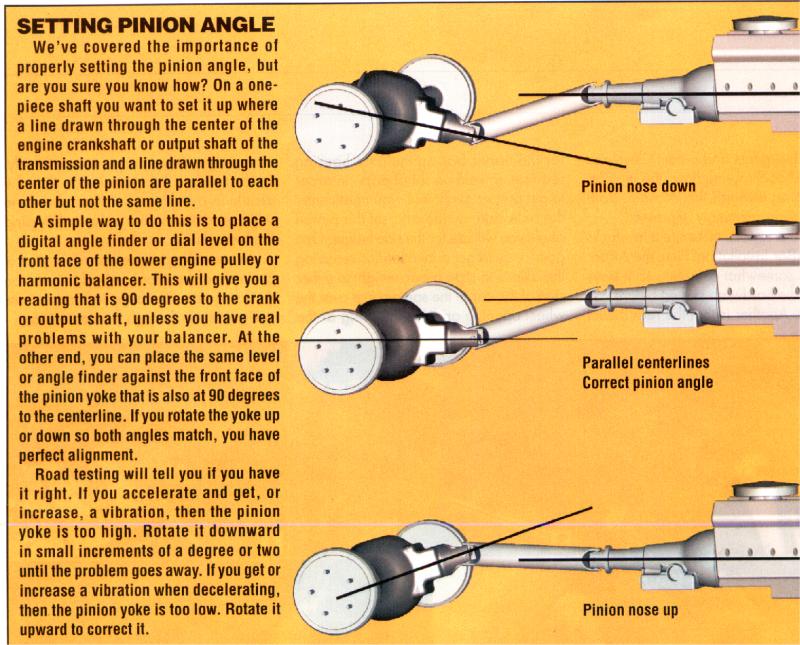

The tranny is 5 degrees unless you move the tranny. What happens when you move the pinion up to match is the pulses from the universals (they don't run in a smooth motion at an angle) cancel each other out and you gain angle at the pinion (zero angle is not good).
I don't agree with #1 pic being perfect, no angle at all means no bearing movement which equals bearing pitting poor lubrication and very short life.
You want #2 pic
Pic 2 min 2 degs so you get ujoint life
you also have to look at side angle as in motor off set and pinion not in centre

What really matters is where they're at in relationship to each other. You want to check pinion angles while resting on its weight, I just put jackstands under the axle. I like to set the car level with the rockers then check angles just so it's repeatable plus pulling the driveshaft makes for a more accurate reading. Turn the pinion yoke facing up and down with the clamps left off to check it then check the trans angle either off of the tailshaft itself or the crankshaft pulley.
Like CDR is saying there's more than one way to get there but you need the angles to run parallel like the illustrations show while trying to preserve some angle at the joints for long universal life.
