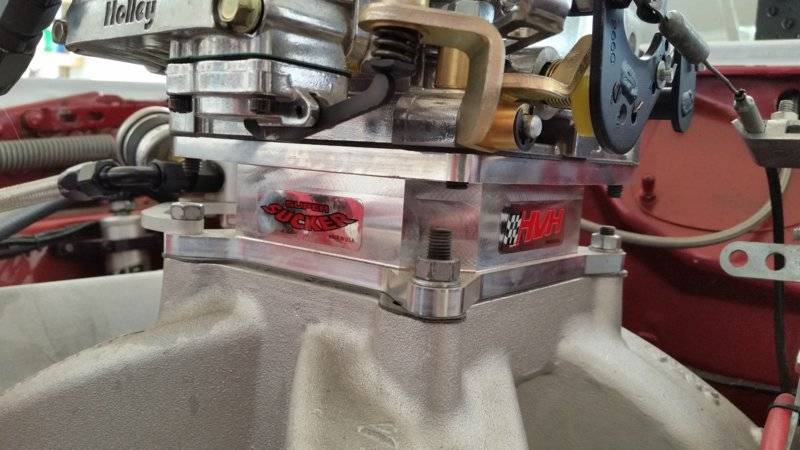

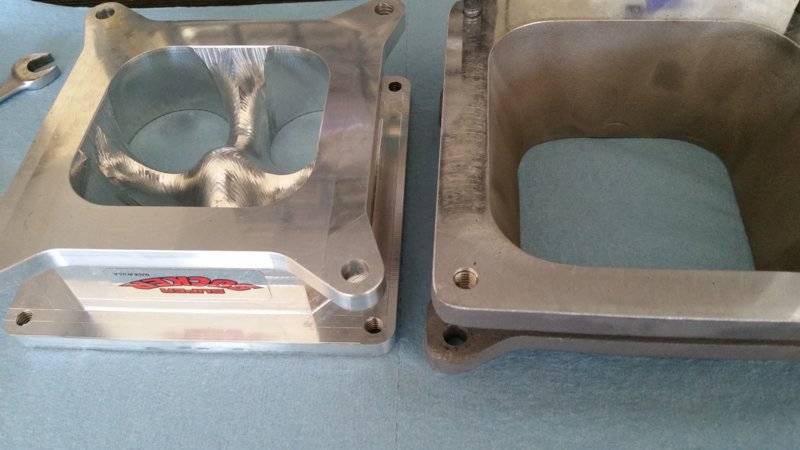

Hey James, have you thought about bolting up one of the adapter plates, cheaper than buying another intake.Like I said before I already have that intake with a dominator carburetor I wanted to buy a 4150 series intake so I can try my thousand CFM HP carburetor and see if that makes any difference if it's better or worse that's why I want to different manifold but I already have the max wedge super Victor with the Dominator
Any information to Andy F and this adapter ?Super vic is standard or max wedge but is 4500 carb . If you buy stock port the super will open up to max wedge , that is what i did .
Andy F does a nice adapter plate to run 4150 on a 4500 if i remember correctly .
