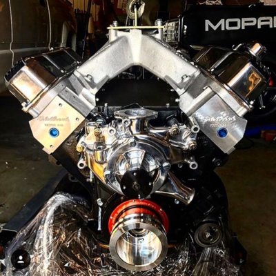

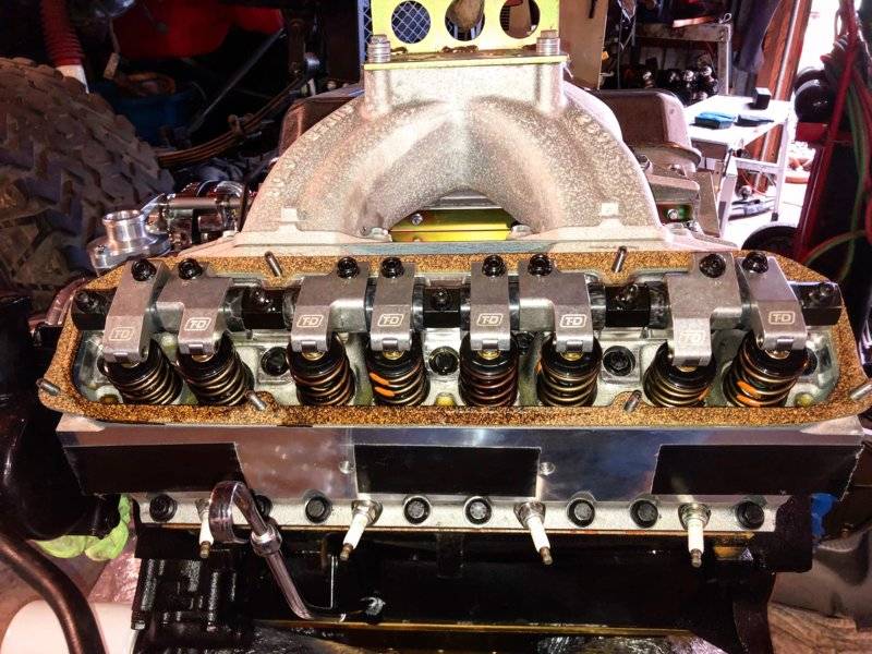

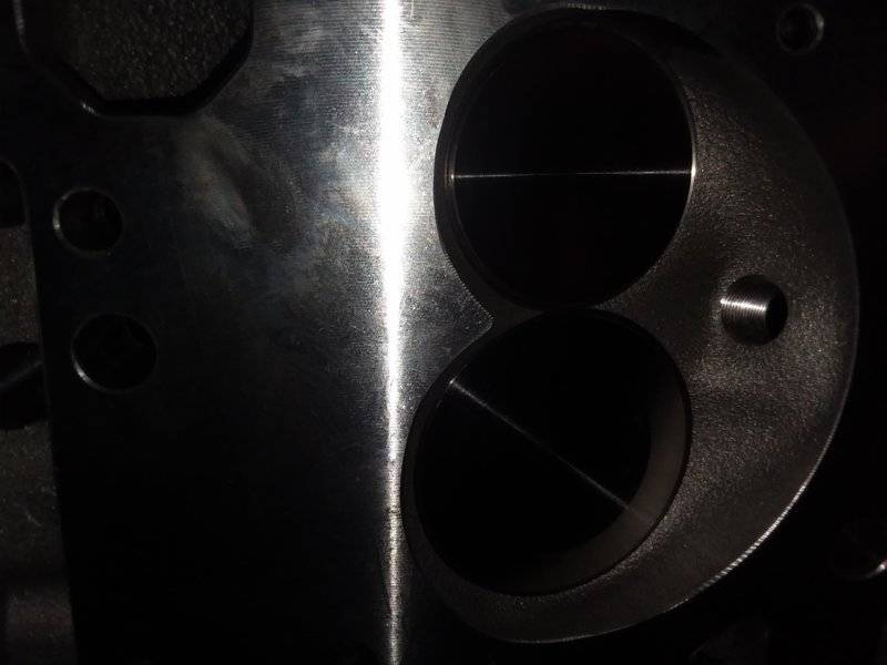

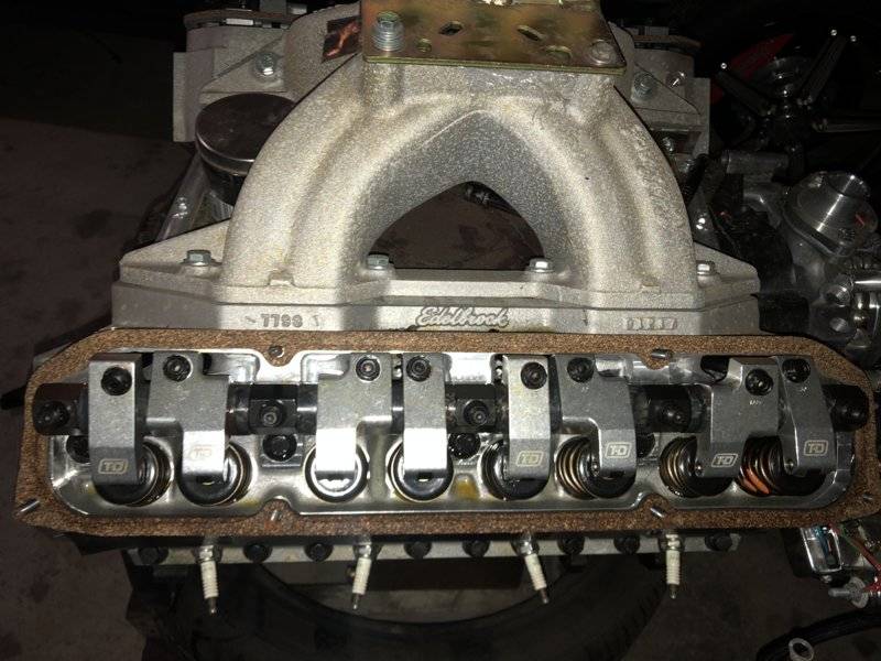

The way i understand it is the earlier castings had flow troubles and the 75cc chambers, the newer castings flow better and have a 72cc chamber. Just going off what my builder told me, we didn’t flow mine but set it up with the t&d rockers, back cut ferrea competition valves, little bit of hand blending. Unfortunately the motor hasn’t seen dyno time or in car action so I can’t attest to how they perform but my builder was confident in them.

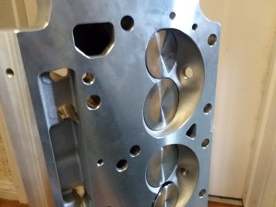

Post a pic of the chambers.
It’s easy to tell if they are the first or second version.
Depending on how much power you’re trying to make, and what you could get selling your heads......it’s very likely cheaper to sell what you have and get some TF270’s.

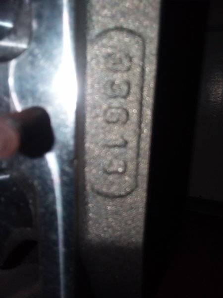

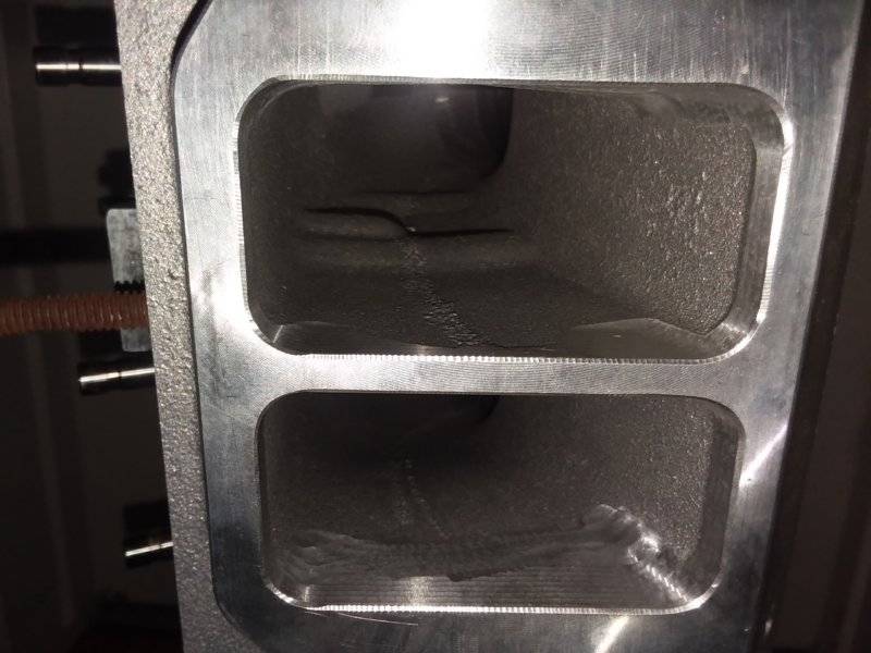

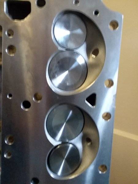

Thankyou Mr. Porter. Here are some pics. As to power, im not greedy. Mild 440 got me mid elevens, all iron real max got me 11 ohs, id like mid tens out of this one, 3450 with me in it.

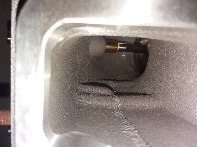

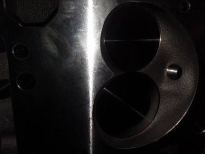

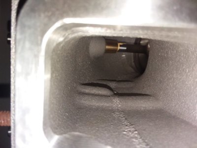

20190723_134230.jpg 20190723_134246.jpg 20190723_134322.jpg 20190723_134254.jpg
Those are the newer version heads.
The chambers are tighter to the valves, so without reworking them the low/mid-lift flow numbers are lower than the earlier heads.
I’ve only had one set of early MW victors in my shop, my “recollection” of those was that they had a very similar shaped short turn to the original version std port victor.
But that was quite a while ago, and I’m just not certain that’s how they were.
The reason I mention it is the later ones I’ve had here(a few sets) have a much taller/more filled in short turn than how I remembered the early version having...... which would only really be relevant in terms of what they flowed “ootb”, and how well they would respond(or end up) with only minor reworking.

Interesting looks and facts about the new heads.
In this case, the “new” is relative.
They changed the castings several years ago....... and they have been the way they are now for way longer than how they were when they came out in their original form.
It’s probably best to think of them as version one and two...... and not get hung up on the “new”, since NIB version one heads still pop up once in a while.
The ones in the pic are version two.

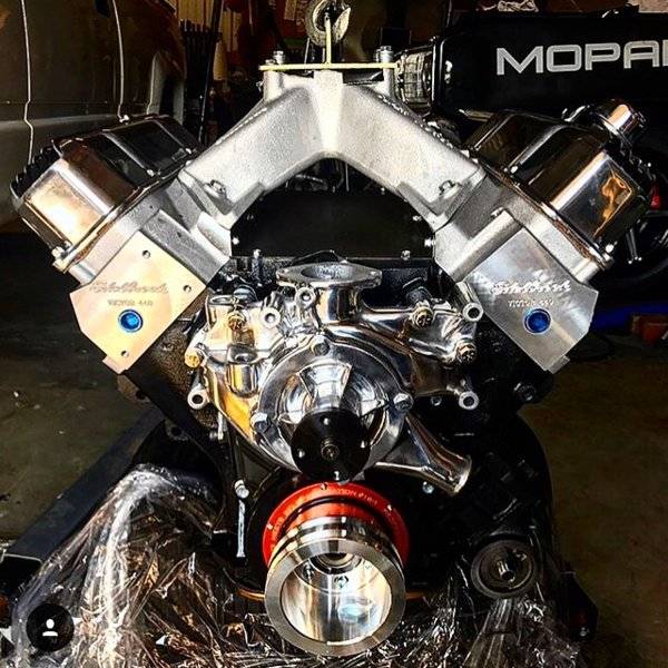

@malex runs these heads on his car with good results.
Correct 67, my Victors on my 505 work pretty good. I don't have a lot of work in them and they put me through the eyes consistently between 10.0 - 10.10. Car is legal to go 10.0, obviously going to stick with them.
