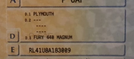

Please could anyone decode the VIN on my '78 Fury 440 police car, I can't find any info on what the first 2 letters RL refer too.
  1. FIRST DIGIT: Model or Car Line.
  2. SECOND DIGIT: Price Class.
  3. THIRD AND FOURTH DIGITS: Body Type.
  4. FIFTH DIGIT: Engine
  5. SIXTH DIGIT: Model Year's Last Digit.
  6. SEVENTH DIGIT: Assembly Plant.
  • R - Belvedere, Satellite, Fury (1976-78)
  • L - Low
  • 41 - Four-door sedan
  • U - (1970-1978) 440 V8, high performance, including police
  • 8 - 1978
  • A - Assembly plant Lynch Road
Have you located the Broadcast Sheet @Fury 440 ?
Try looking under the rear seat cushion between the seat springs and seat foam. There are a bunch more codes on the Broadcast Sheet than on the fender tag.

I haven't had chance to look for the Broadcast Sheet yet but I will when I get the car back.
