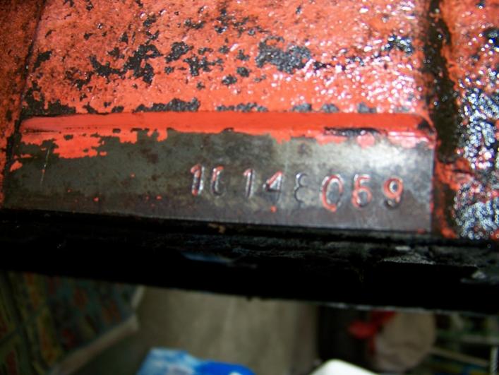

yes that is correct and there is a VIN stamp on the lip of the trunk rail by the dutch panel. the engine numbers will be located on the PS oil pan rail underneath and to the left of the motor mount.
