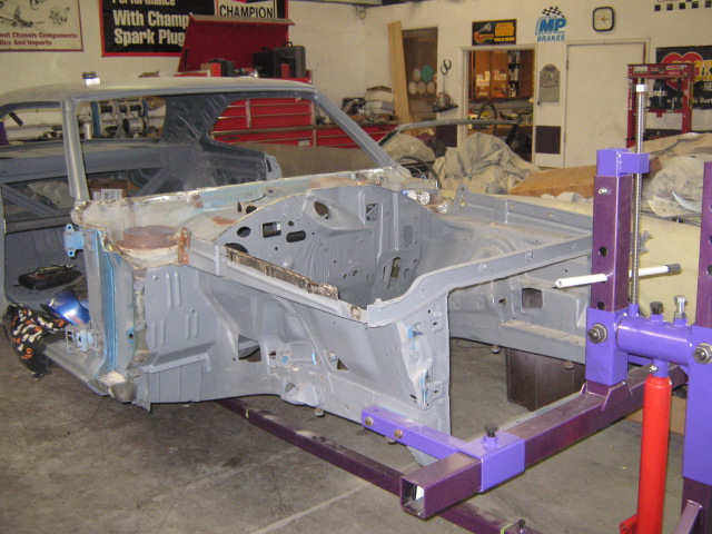

I plan on a Vintage Air system in my 70 GTX project. This is NOT a "factory original like" type of retoration so "convinience" type mods are the order of the day.
My question is, has anyone installed a Vintage Air system in a B Body like this and if so how was the fresh air vent handled?
I was blown away at how rusted the top of the cowl was only to find NO rust on the deck beneath it! Except for the fresh air vent extensions (see pic).
I'm thinking about trying to rig up something more like the vents in my 69 Dart. They work better than the &0 GTX ever did and are a lot less complicated....no cables and such.
Anyway, heres hoping to open a flood gate of tech q&a so this site can start cookin!
I know there is a system that eliminates the heater hoses and core, and routes the A/C lines in through the existing holes. Don't know about the fresh air. But I would guess if that system eliminates the heater core, then there is probably some accommodation for fresh air.
To my knowledge - there is no provision for fresh air aside from the stock driver side duct. The Vintage air unit does not pull fresh air from the cowl area. There is usually a block off plate provided in the kit which kills the possibility of the fresh air.... seems the kit merely pulls air from the passenger compartment.
