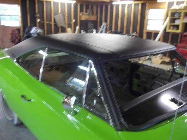

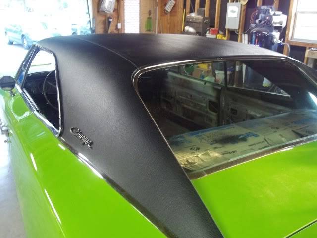

I just installed one myself on my '69 (it wasn't a difficult job, but the glass was out). Might wanna try it yourself and save some $$$$.
