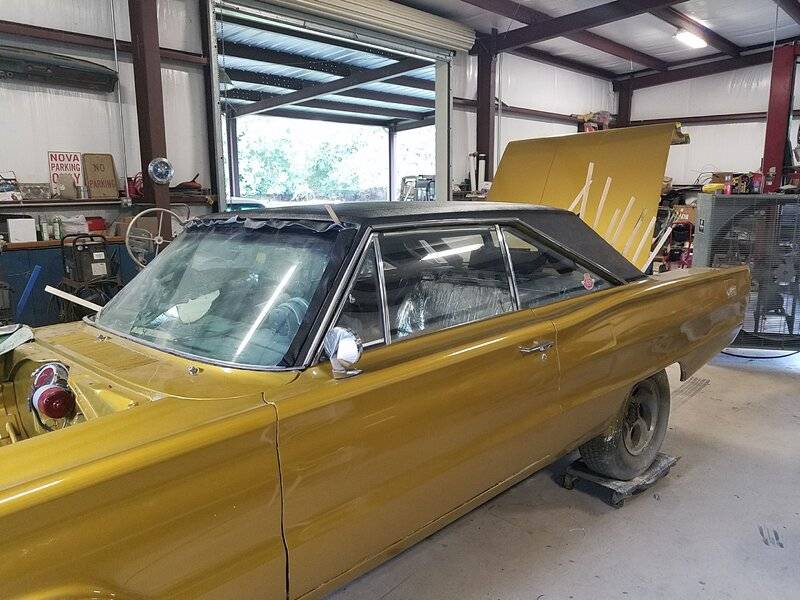

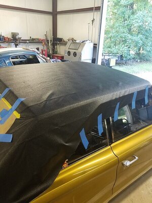

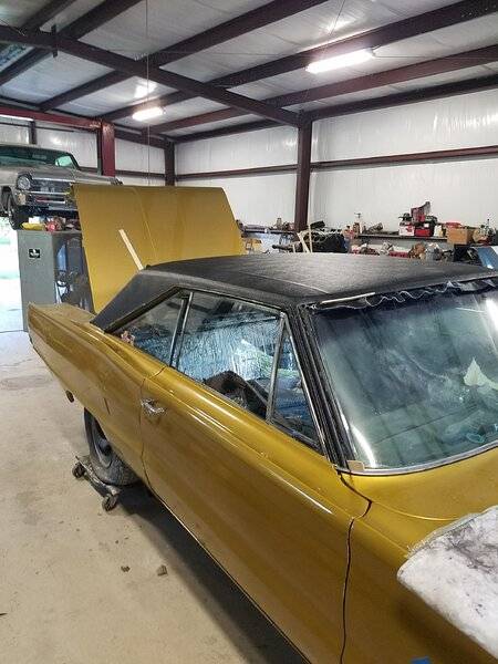

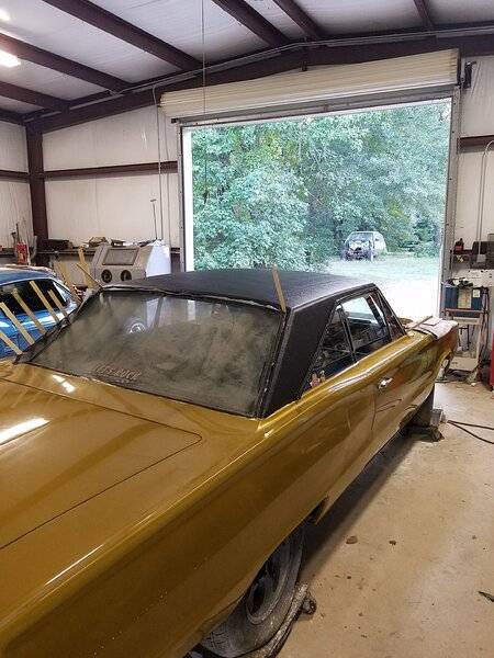

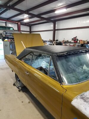

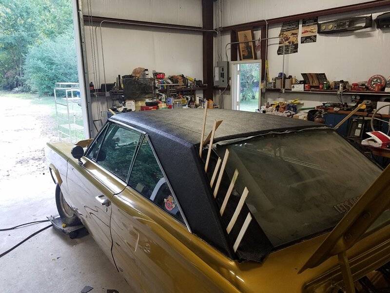

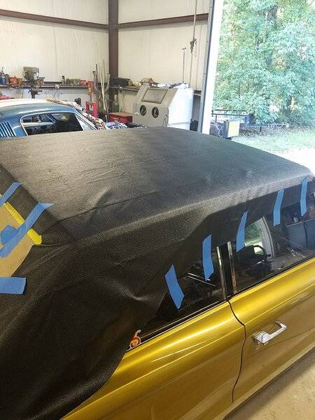

I did mine, it was pretty straight forward. I used the Weldwood Landau Top adhesive.
Had a cheap harbor freight spray gun and sprayed from the center out, you have to do both the metal and the vinyl, let it sit until its tacky. Used a foam paint brush roller to work it from the other side ( unrolling it). Only did about 12-16" at a time. When you get to the drip rails you need a soft (but rigid ) edged type putty knife, I used a plastic body filler spreader, to tuck it into the drip rail . Also had pieces of wood that fit in between the rail and roof that I clamped until it dried.
Get a large box of razor blades. If you have a bubble get a syringe and inject some adhesive into the void and roll it out.
Make sure you put on enough adhesive right above the windshield and around the reveal.
Laying it out took the most time..once you start gluing you're commited!!!
