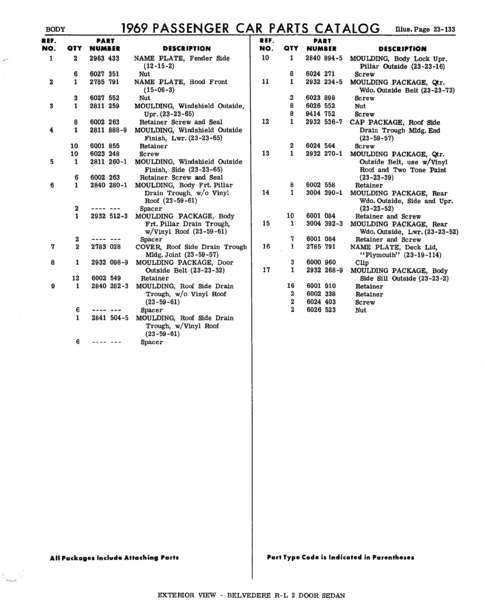

I stand corrected. Here is a copy from the parts manual for 69 Plymouth B body. It does list 2 part numbers for drip rail trim. With and with out vinyl top. I do know from past experience of putting on tops of dozens of cars, the trim will work for both applications. Yes, it is a pain in the rear to remove and install this trim, but it can be done.
