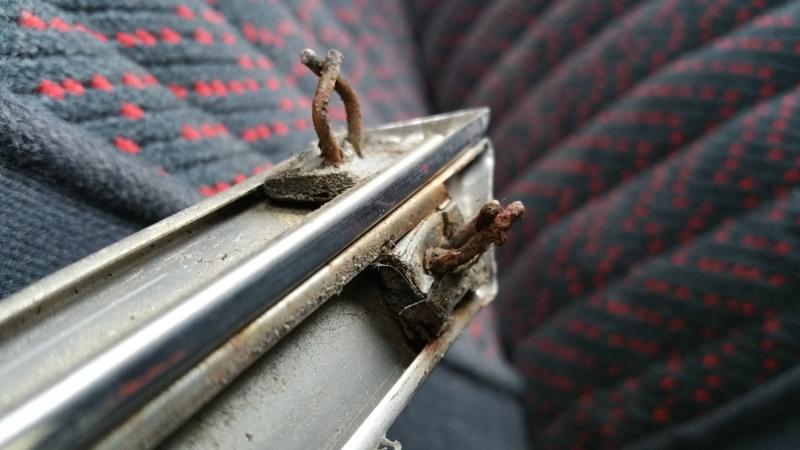

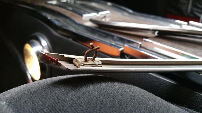

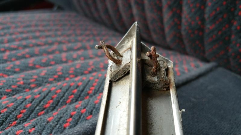

OK, I've had a leak in what I thought was the back window of my 69 Coronet. I took it to a glass shop that I trust, and they re-sealed the window, while doing it they found some holes, but I told them to seal it as best as possible for now and that I'd be redoing to body in a few years and I'd just like to get that out of it. But a leak persisted, I brought it back because the owner wanted to try again, and I had no problem doing that. Well he was trying to find the leak, he found the window was fine but the vinyl top trim (which isn't on anymore) pieces were the cause. Who ever restored the car 20 years ago just put regular screws in and they have been the culprits all along as well as the window before I had to fixed...
Does anyone know where to get new proper retainers to fix this?
I can post a picture when I get home later...
Anybody? Anyone know where to get these clips or at least a part number?
These are the clips, are they the right clips? I'm use to GM and their clips are different…
Thanks Coronet14, RT specialties has what I'm looking for… Those are the right clips, I guess Butyl tape is needed with them, something that was not in there…
